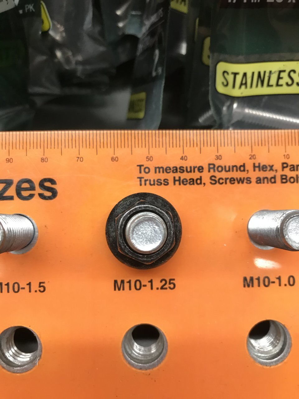

    Anybody know the thread size for the 3 bolt that mount coil overs ? Just got a set of BP 51s and they didn't come with the 6 bolts to mount them. Thanks!

    They’re M10-1.25

    Anytime, fyi the part number for the bolt is 9008017215 (Strut Mount Nut).
