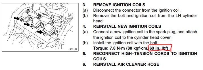

    That aluminum sure is soft. I was worried about stripping it, so I looked up the torque specs. 7 foot lbs. Not much. The dreaded feeling of the bolt going from hard to turn to loose, that means a strip, I never got to 7 foot lbs. That or my new torque wrench is wrong. I did the other 4 with the 2 finger tighten. When it feels snug, time to quit. I guess there is a hilicoil, or tap job in my future. Besides keeping moisture out, is this an electrical connection? Ground to the coil pac maybe? What is a good solution? Has anyone ran into this with a 2.4 before?

    Where did you look up the torque spec? I didn't see the 2.4 coil spec in the FSM I have. At least for the 3.4l it's not 7 ft lbs. It's 69 inch lbs (5.75 ft lbs). That still seems high to me. Stick with the finger tight, plus a small nudge with the wrench.
    Either way, what's done is done.
    I would assume a Helicoil is going to be your best bet.

    69 inch pounds / 12 inches per foot = 5.75 ft pounds
    What is the range on your torque wrench? They aren’t accurate at the edges of their ranges.
