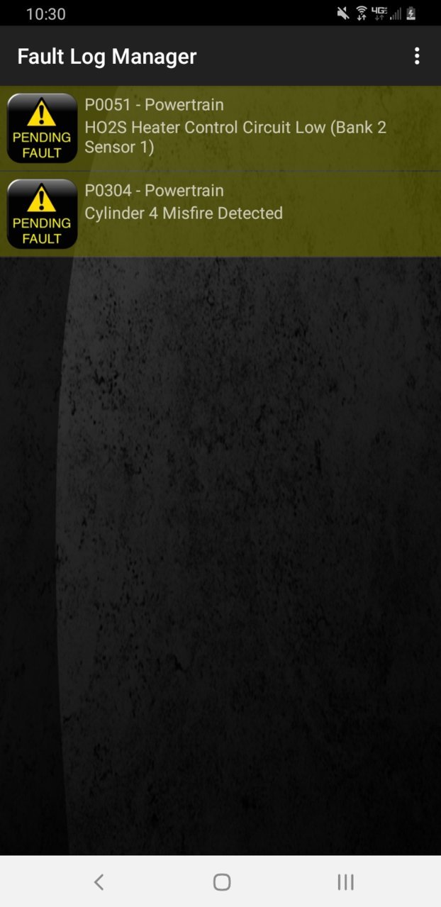

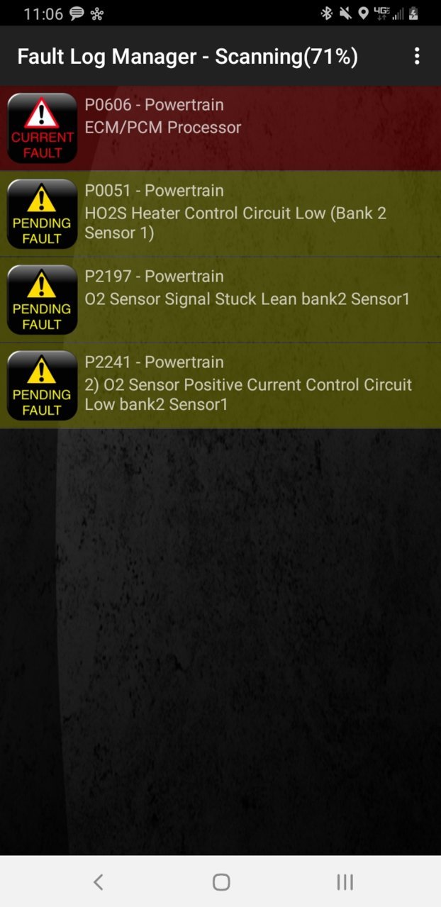

    At least 1 or 2 every year randomly go bad, usually the same one it seems. I feel like these shouldnt go bad that freaking fast. I had gotten an ECM code recently I'll have to see if i can find the code. I also have the O2 code that no matter what ive tried won't go away. Starting to wonder if my truck is just dying and time to get rid of it. Idk. Anyone had issues like this. 2005 tacoma prerunner 4.0 v6 Screenshot_20211218-223056_Torque.jpg Screenshot_20211116-110629_Torque.jpg Screenshot_20211218-223056_Torque.jpg Screenshot_20211116-110629_Torque.jpg

    Pop the #4 coil out and see if it’s dry or wet at the plug. If it’s wet, it’s time for valve cover and spark plug tube gaskets. Good luck!

    Maybe the misfire code at #4 isn't being caused by a coil pack. A good tech can scope the primary (control) side of that coil and see if the pcm is controlling it correctly. And also verify harness integrity
    Same for the b2/s1 oxygen sensor
    That processor code is kinda bad news

    If the coil is really going bad then swap it to another cylinder with another coil pack and see if the fault follows misfire to that cylinder as well. Multiple issues at play here with downstream sensor also, numerous reasons could be causing that issue. I would baseline and chase the misfire first. Zero out codes, swap coils to another cylinder and see if code follows coil.

    The P0606 concerns me that the PCM is going bad, if it is then chasing the other codes is moot since bad PCMs can flag false codes.
    I would first verify your battery is good and power and ground at the PCM is good as low voltage can also set false codes.

    Thought that as well...processor code disappeared and hasnt come back either though. Hope i domt need a new ECM/PCM still cheaper than a new car though
