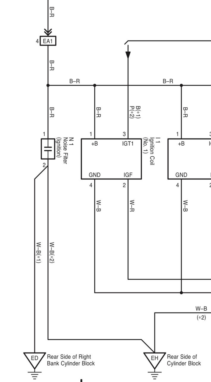

    excessive heat up of house battery. In theory the battery will act as a large capacitor and filter this noise out but if the noise is large enough it cannot suppress it all. Other components that rely on PWM switching can be seen affected, maybe something like fuel injectors, VSV, or purge flow for the EVAP come to mind. Aside from that there won’t be many symptoms but noise will degrade the life of components designed for clean DC power. i would put a scope on the output of the alternator to eliminate this as potential cause. There are numerous other things as mentioned earlier that could also be a cause of failing, there is also a noise filter right at the coil pack circuit to try and prevent this from occurring but this could also have gone bad from excessive spikes due to ripple over time.

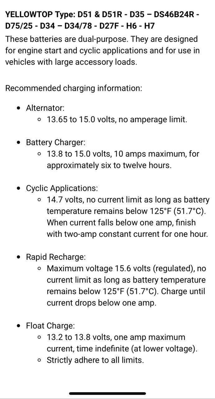

    It is also true that an AGM battery requires a higher charging voltage due to a higher OCV. these will usually be specified by the manufacture of the battery and you can use a voltage booster for your alternator to raise the charge voltage to the battery as required. Here is example from optima website

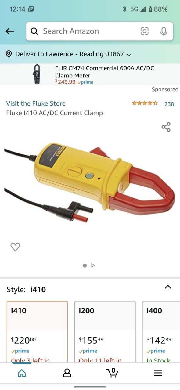

    @Key-Rei that's a decent meter. I'd suggest getting an amp probe for it.
    Something like this, rated for both AC and DC
