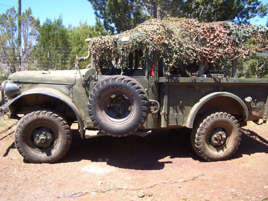

    Keep in mind, I wheel with this:
    :D
