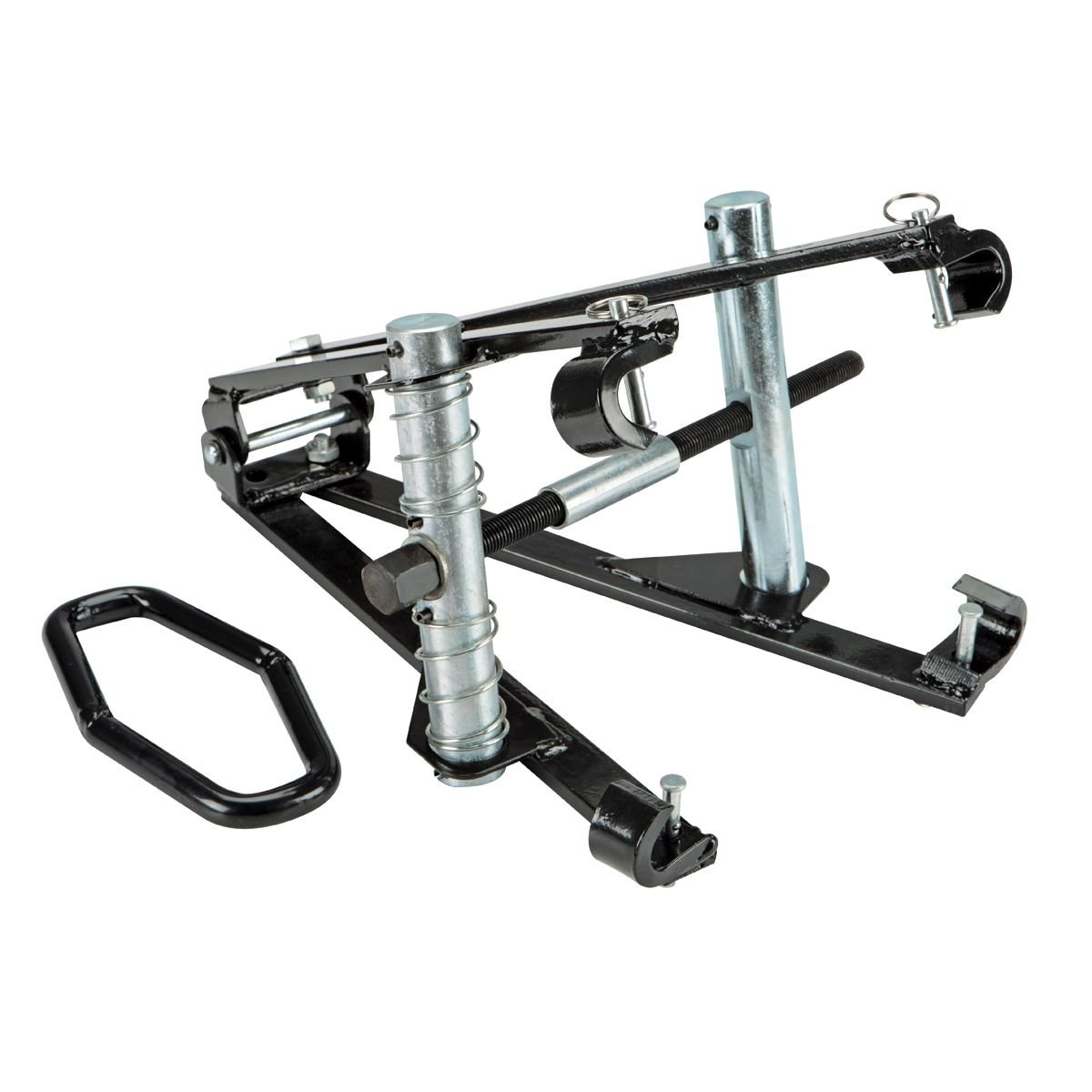

    I had the same thoughts when I did mine. I wonder if the spring, no longer under pressure, expands, or gets stiff with age? Keep in mind mine has been in a "not under pressure mode" for about 10 months. The bolt heads on the compession tool are now butted up against the UCA, so i must use a open end wrench to remove them. No room to get a socket in there.
    No worries. My friend is coming by this weekend to help. Either that will do it, or I will buy the fancy compression tool. For sure, its going in!

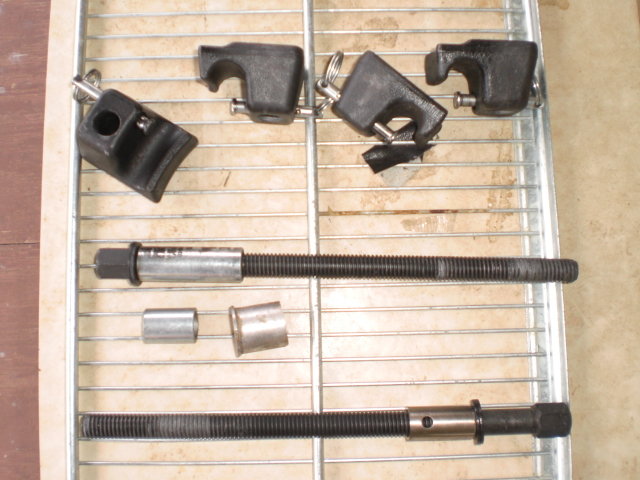

    When I did mine, I just went and bought a brandnew OEM brand one from autozone....$40.
    I had complete confidence in its safety, little truck, tool was brandnew.....
    OEMTOOLS 25550 MacPherson Strut Spring Compressor (autozone.com)
    Although I made a variety of metal sleeve sizes and put on that clamp screw to space clamps closer together and away from nut/washer/wrench end...to gain wiggle room around top cap.....
    I used metal cutoff tubes left over from ceiling fan extension kit....an inch or inch and half long.
    Like I said, it was a puzzle......

    That is the one I am using now. It came from autozone,but I am renting it.
    This is a good idea you have about using a sleeve/ spacer. I may try that. I think if I could gain another 1/2", I would be there. But it takes some serious torque to turn it at all. When I do (with my big 21" bar) it creeks and groans, at one point I could see the threaded rod flex a little. Not safe. If the weather holds Ronald will come lend a hand. He knows more than I do.

    you're suppose to grease those screws.......said so on instructions....
    And yeah those screws are about inch and half too long for our little struts.....
    You can see from pic I had to use two spacers on each side, like 2 to 3 inch......from nut.
    And then on driver, one screw had to go upside down to make it work.....
    passenger slid in with no such non sense....
