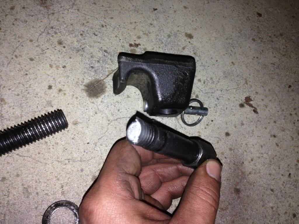

    Damn.
    And while we are on the subject....anything from Harbor Freight might as well have a sticker on it that says "Widow Maker."

    What happened to the spring when that cheap compressor failed? Hope no one got hurt, yikes.
