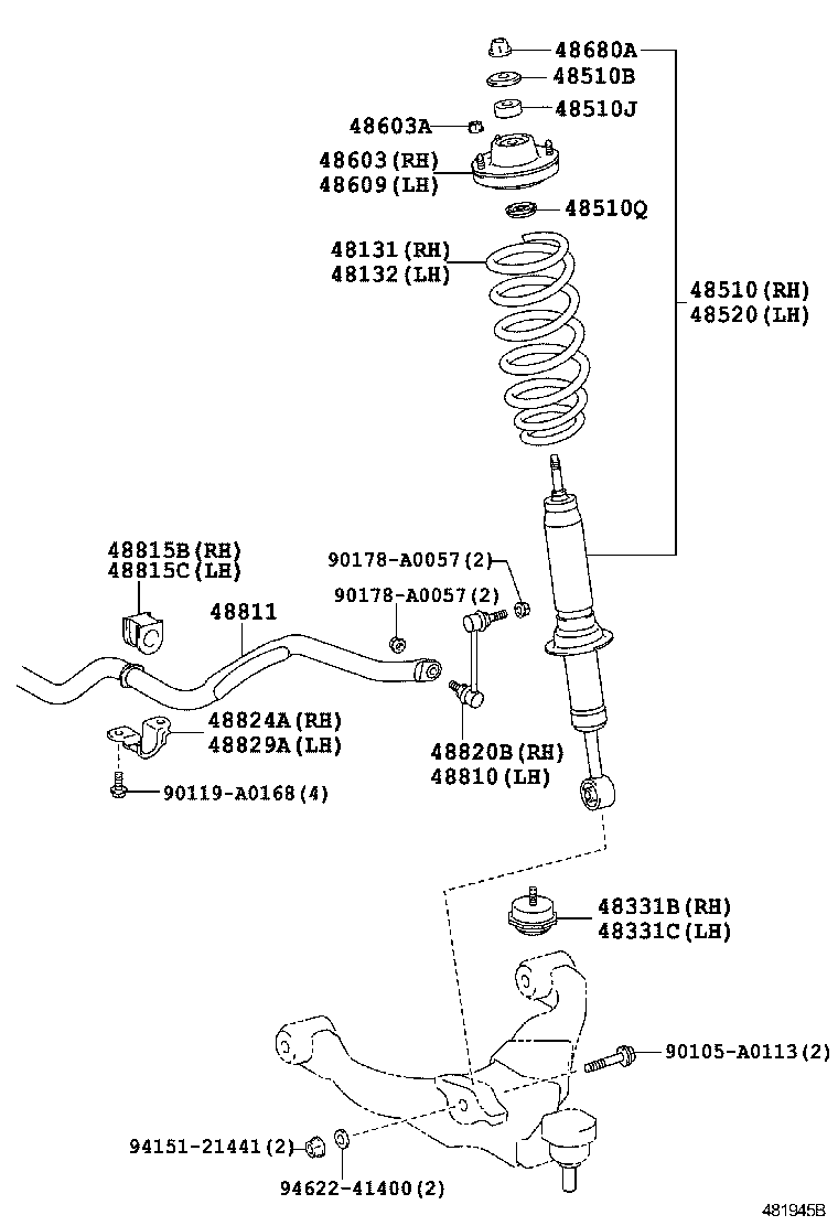

    Looking at the diagram, there is no part number for only the rubber isolator. If you want to go OEM you'll need to replace the whole top hat.

    It looks like it’s all one piece

    Is is, so OEM is off the table.
    If you want only the isolator, here you go. Or you can replace it all.

    that's what I will do..Can I just drop it down or do I have to remove the spring and shock/

    unfortunately you'll be removing the shock/spring entirely.
