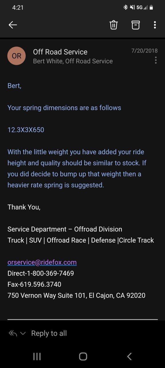

    Here's the email and contact, in case you or anyone else has more questions.
