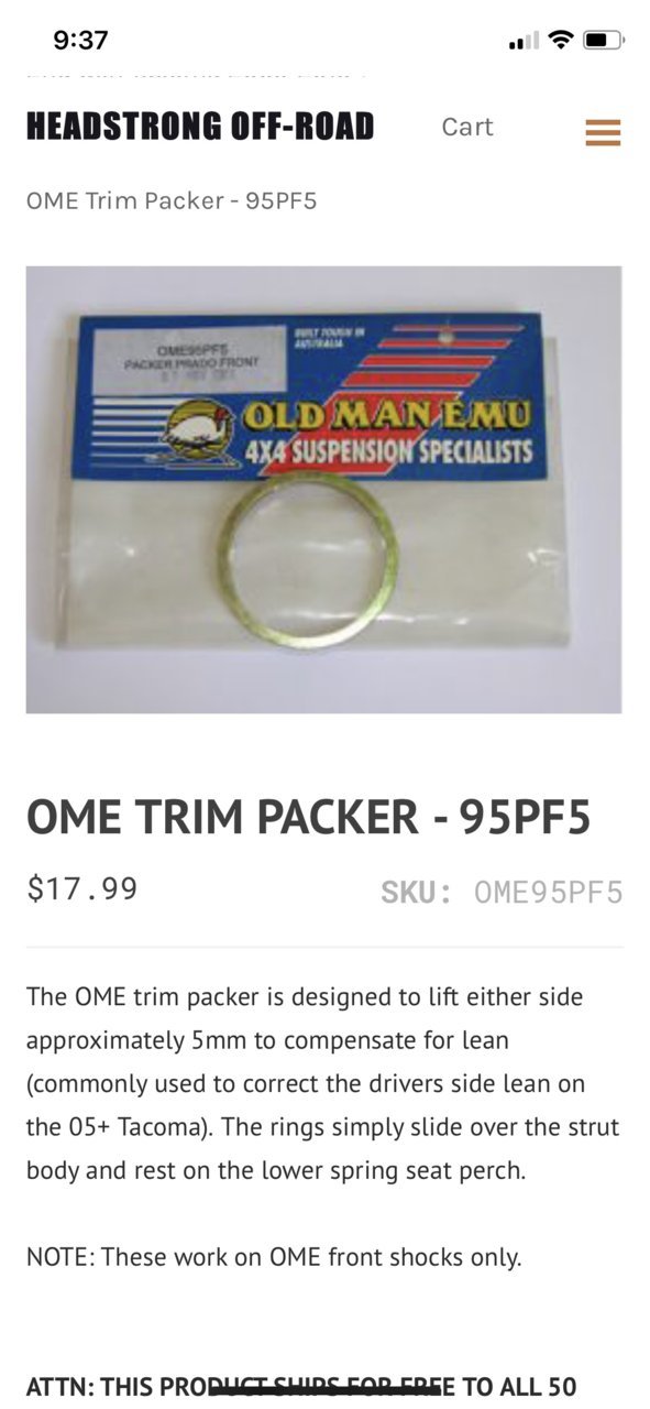

    Thanks for chiming in. Very helpful info. I planned on doing the 887 with the spacer that OME sells. Is this what you used ?
  4. Feb 26, 2022 at 6:46 PM
    #44
    swissrallyman
    swissrallyman Well-Known Member
    Jun 14, 2010
    #38945
    394
    2017 Tacoma TRD Sport
    that's for the drivers side, basically adds 5mm preload to compensate for a taco lean towards the drivers side (battery and fuel tank both on drivers side) On top of that something like https://www.headstrongoffroad.com/store/p30/HS_1/2"_Top_Plate_Spacers_-_TT05512-TPS.html or in any case when you assemble your shocks use some extended studs. then you have the optionality to add a little spacer later if you don't want to right away. The 887s will still give you 2 inch lift right away, once they are broken in they will sag a bit and I added the spacer at that point.
    again that's just my set up... others might have different views. cheers
    908tacoma likes this.
