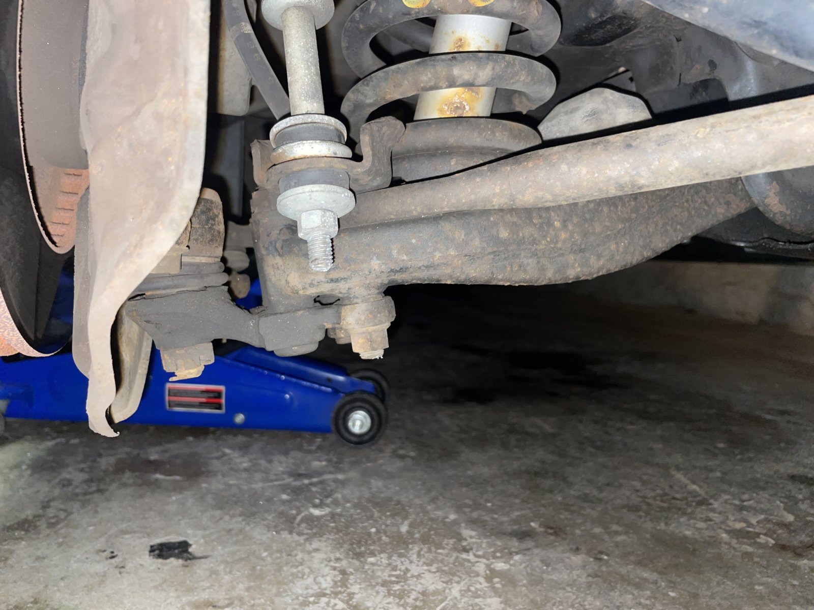

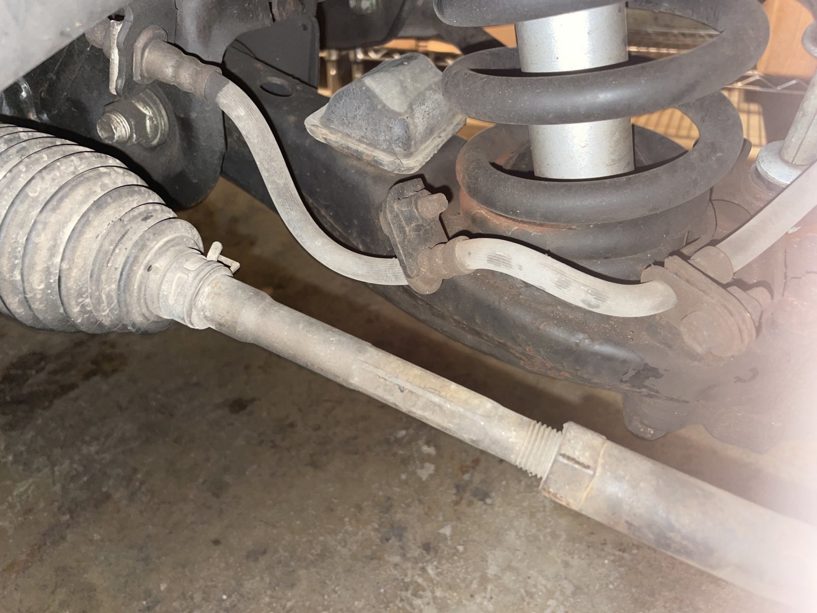

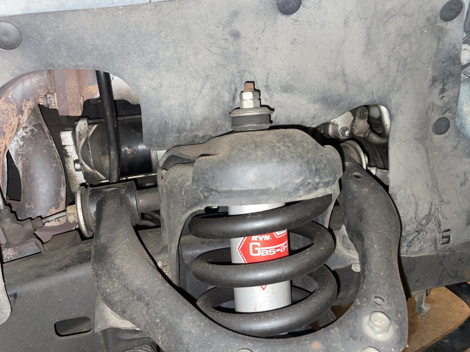

    I want to replace my sagging front coil springs. Many pics and links in the sticky are broken at this point, so it's not very helpful.
    How easy is the coil spring to pull out of a 1st gen 2wd 5-lug? It's the design with a single nut on the top of the strut as shown, not 3 nuts surrounding a center nut.
    The FSM basically has this procedure plus more steps after, which seems to be oriented around removing the LCA to replace LCA bushings.
    1. remove shock
    2. compress coil spring
    3. remove stabilizer bar
    4. remove LBJs and LCA
    5. remove strut bar
    6. remove coil spring
    Is removing the LCA and LBJs necessary for the coil spring to come out? I don't really want to mess with those. Does compressing the coil spring the right amount lift it off the LCA so it can pull right out sideways?
    Here are pics of passenger side.

    Im pretty sure that is correct.
