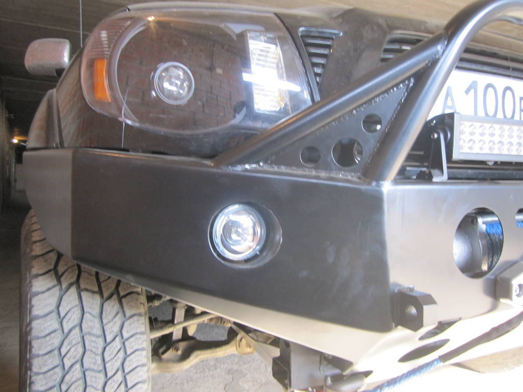

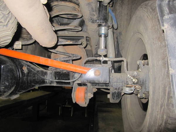

  13. Jul 12, 2018 at 8:54 PM
    #53
    05Taco4x4
    05Taco4x4 ToyotaHubs
    Jun 29, 2011
    #59085
    6,222
    2TR-FE Enthusiast
    FJ Tcase, Manual Hubs, 2017 Head unit, Mirror Riser

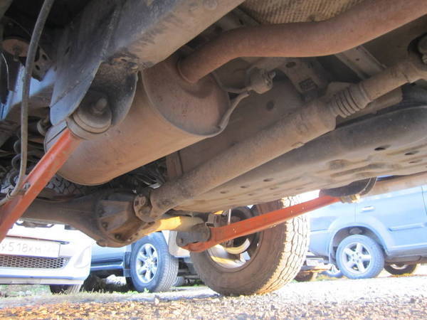

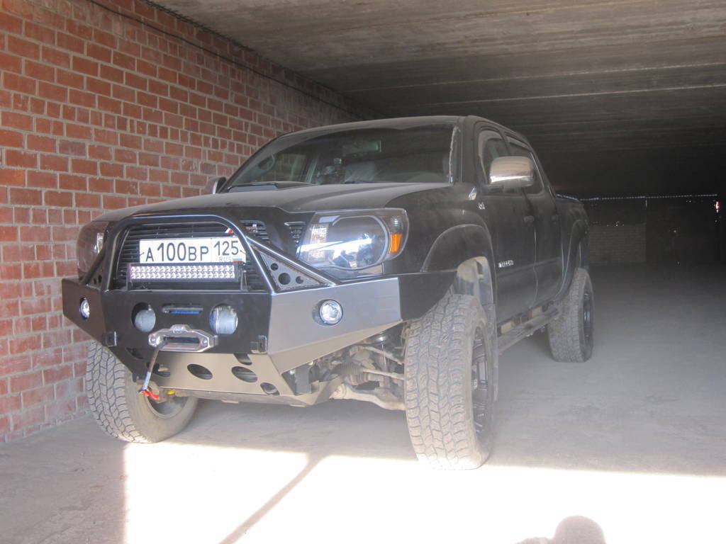

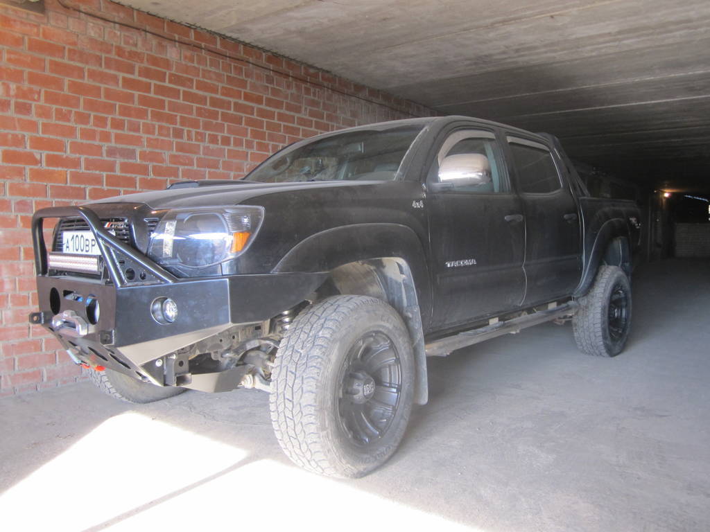

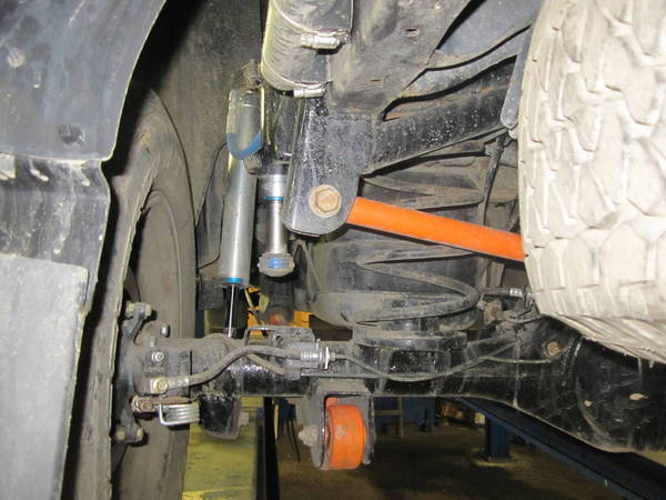

    From crazy Russian's build thread, better pics of how he put it together.
    I don't see any sort of limiting strap or his coils being tied into the mounts, something I would definitely do.
    Notice he also optioned for the rear disc brakes
    :cool:

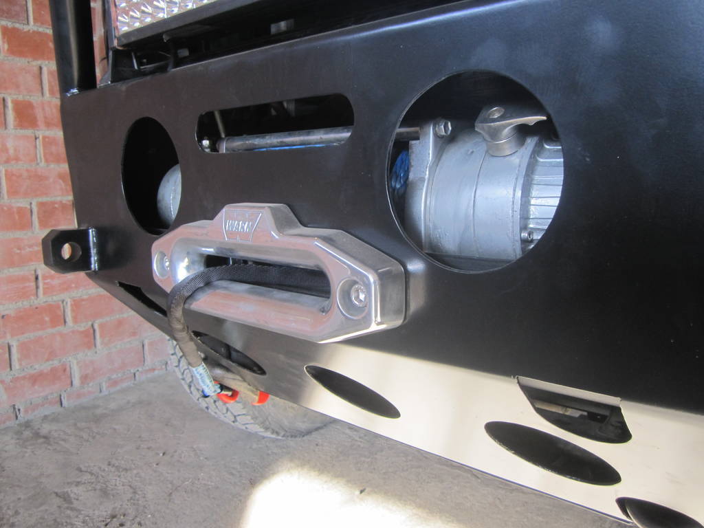

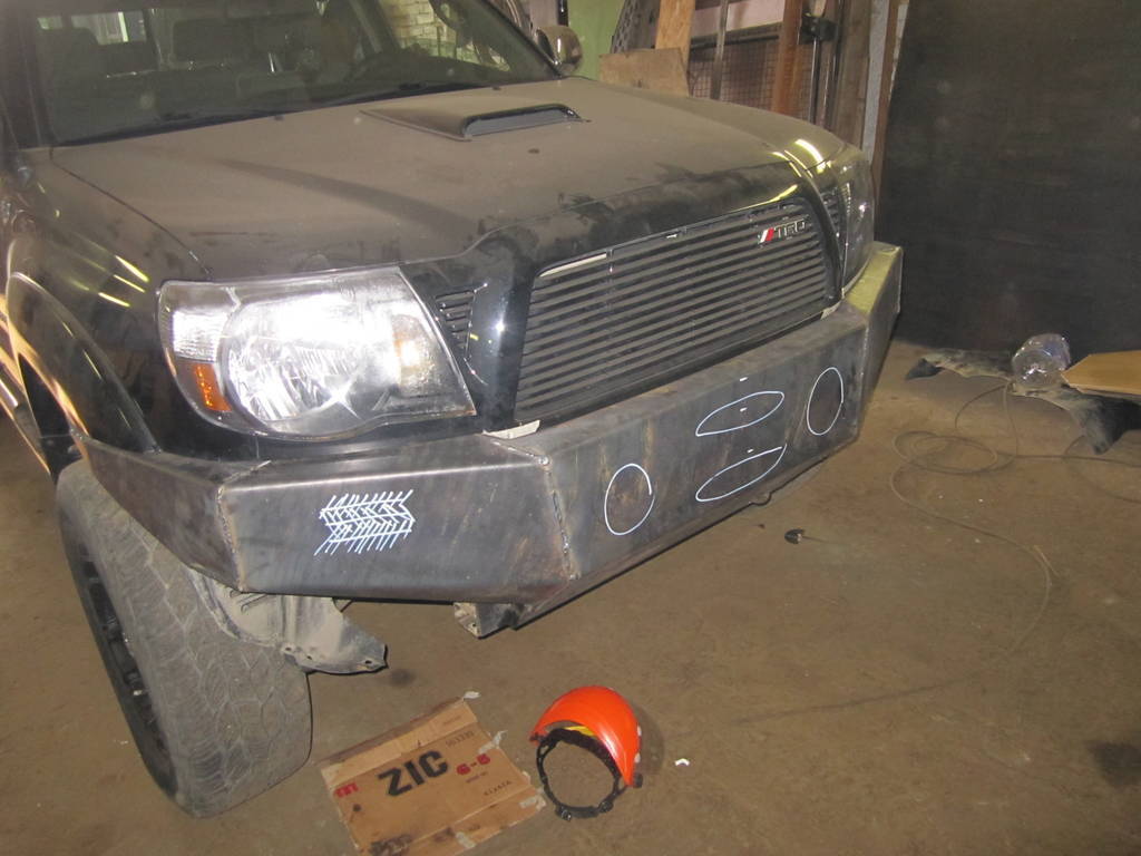

    The man built his own front bumper!
