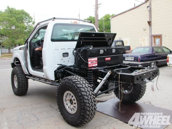

    I will getting a 15' or 16' Tacoma in the coming year. I am deciding on whether to put coil springs or coilovers for a rear 4 link set up. What do y'all suggest on what type of 4 link I should run? What are the pros and cons of both coil springs and coil overs? Attached below is a similar rear suspension coil spring w/ shocks build that Shaffers Offroad in the Bay Area did on a F250.

    all depends on use. The setups above with a stand alone coil and shock are for flex... not high speed.
    A true triangulated 4 link and proper coil overs are going to allow you to do high speed stuff as well.... but will cost more money.

    @nd4spdbh, chiefmanywrenches- I am looking at an all purpose rig that can be a daily driver, haul items in the bed (thus looking at coil spring w/ shock set up to retain all of the bed space), expedition, and rock crawling as well. This will not be used for high speed, pre-runner type off roading.
    @nucktaco-the f250 runs a parallel 4 link wherein, all of the four links are parallel to the frame. None of the links go inside to where the gas tank is.

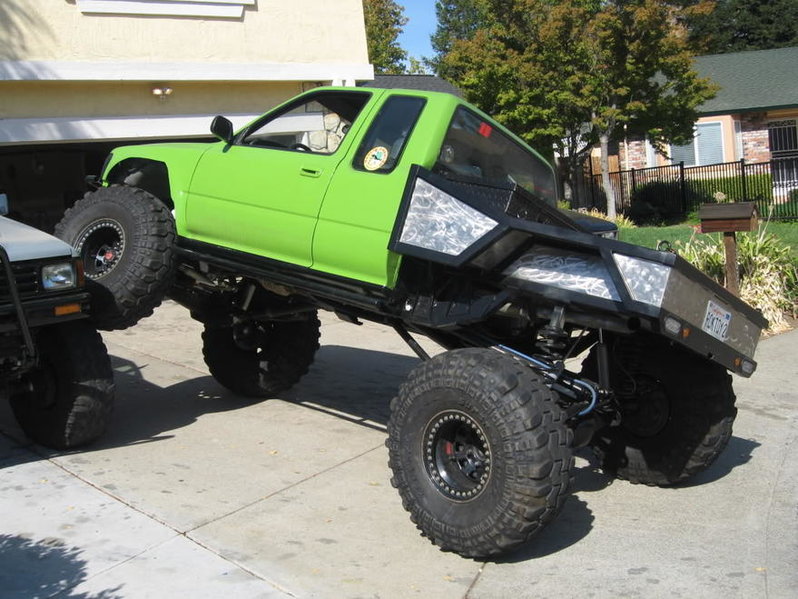

    However, the advantage of a rear coil spring setup is that I am able to shorten the frame behind the rear axles to increase departure angle.
    Also, I plan to have a parallel 4 link flatbed like this:

    You can bob a bed on leafs too. Just not as much

    If i were to go for the rear 4 link parallel coil spring setup, I can bob the bed as much as 16-20 inches. That is more than for rear leafs.

    that f250 is insane. it is has a shortened frame by 2ft in front of the rear wheels, portals and of course the fully custom suspension. that truck was built for the 2013 petersons ultimate adventure.
    so you're gonna spend 55-60k on a tacoma to wheel?! good luck and enjoy it!

    @bzzr2, KyleNowad- basically, I plan to have a very similar build as the f250 for the petersons ultimate adventure, except the frame will be shortened behind the rear wheels, have a flatbed, and have a long travel IFS to compensate the lift I will get out back.

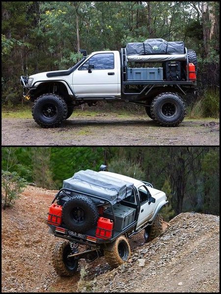

    I am looking at replicating a build that looks like this:

    You are going to spend way more than 60k on that set up to get what you are talking about. Go get a salvage titled truck or an old road worthy truck and do it that way.

    211
