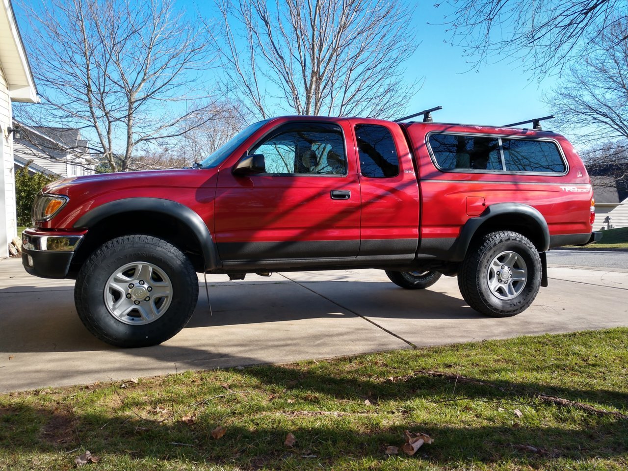

    Heres mine on 880's/5100's and a 1.5" add a leaf out back. Tire size is 265-75-16

    With a 2.7 and original bumper? Does it ride like a excavator? I have roughly 1” spacers in there so I imagine I only need the 880’s giving me 2”

    Exactly my setup. Perfect. Thanks everyone
