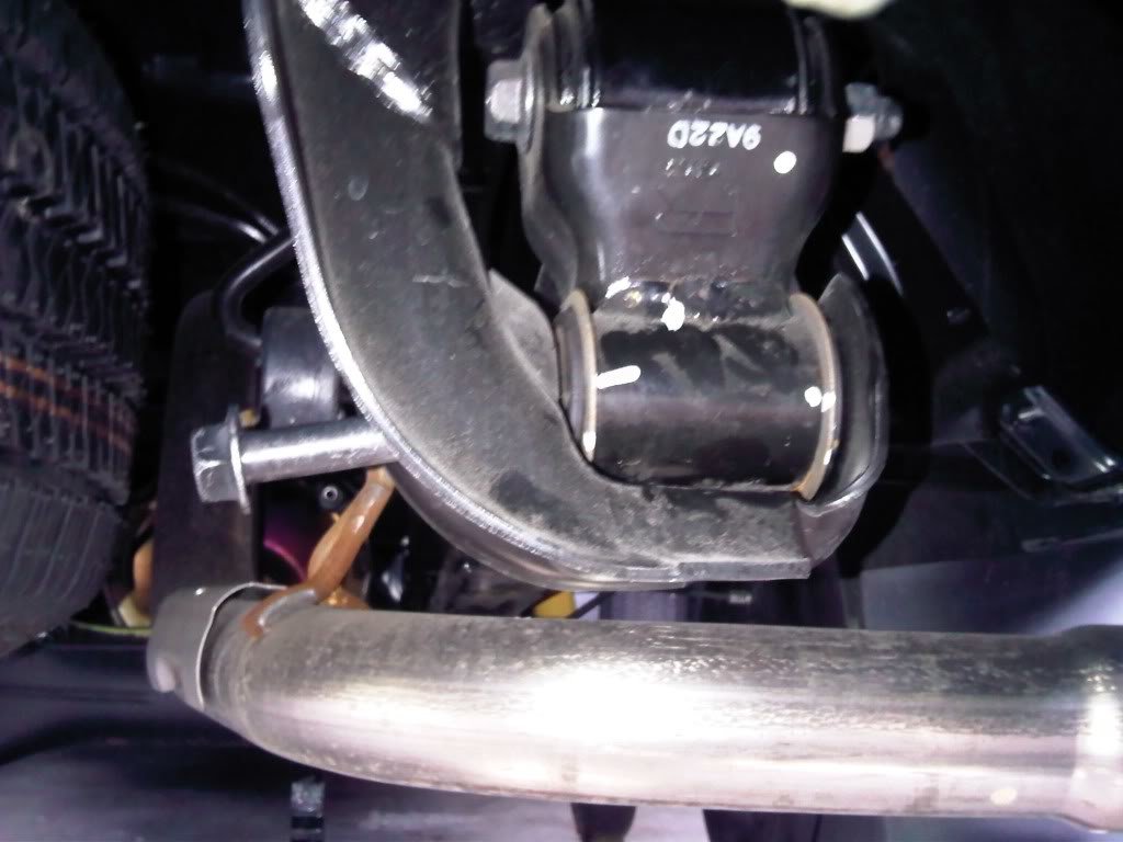

    I was going to do this, put how in the world did you get the bolt out near the gas tank and the muffler? I forseen this problem and by looking at these bolts, it seems they would be very hard to get out. You have no room to tap the bolt out once you get the nut off.

    Getting the nut off was the tricky part... after the nut was off... the bolt slid right out for me (on both sides). But for what you are doing you shouldn't need to remove the springs.

    So I changed my mind and was going to take out the whole stock leaf pack to add in the 3 leaf. I took off the nut on the rear part of the leaf, and then tried to bang out the bolt. It is almost out, but it seems that the leaf pack is pulling up and I can't get the bolt completely out. What am I doing wrong here?

    There might be a little weight on the spring, I had a similar problem when I did my new leafs. If you can move the axle at all try going up or down just a little bit until that bolt is lined up again and it should pull out. If not get a bar in there under the head of the bolt and pry that mother out!

    Fck for the life of me I can not get this bolt out on either side. If I wanted to, I can't even bang it back in because the hole doesn't line up on that side now.

    try jacking it up a little and and pulling down. If not, then get like a 3/4 wrench and put it under the bolt head, then hit the wrench with a hammer. Get it?

    The way your bolt is pointing down tells me that your springs are wanting to bend upwards. You need to alleviate tension off the springs by lowering the axle (just make sure you don't lower it too much and stress the break line).
    If you have your frame on jack stands and use a floor jack under the axle, you should be able to lower the axle down enough to remove tension from the springs. (I assume you have the U-Bolts and shock removed?) At this point, you should be able to pull down on the shackle (and the spring) enough to line up the holes and pull the bolt out.
    Position yourself behind the shackle and pull straight down and avoid twisting the shackle inside of the bracket. It should pull straight down very easily. If not, make sure the springs aren't crooked or twisted. If they are try and straighten them out so that when you pull on them, they slide straight down.

    Ya I was just sitting in the garage trying to figure this out. Right now I have my jack stands under the axle, which I think may be up too high putting pressure on the springs. I'm going to move my stands to the frame and then lower the axle. Hopefully this works. The jack that I have won't work to lower the axle, so another trip to Canadian Tire. Need to buy another jack.

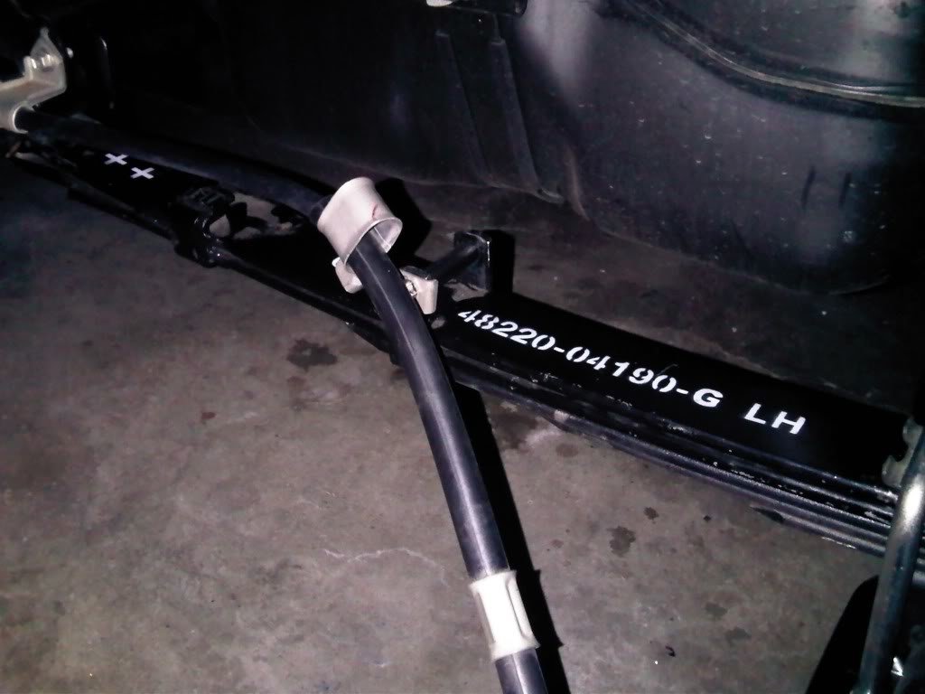

    Tacotown, you are the man! That was exactly what I needed to do. Once I did that, the leaf springs were easy to get out, assemble and put back in. I'm just about to mount the wheels back on, but I am unsure about this cable. It goes from the brake drum to the front of the truck. On the stock setup it went through a little mount that was attached to the springs. I put it back on that way, but there seems to be a lot of tension on the cable. Should I keep it in the mount like I have, or let the cable be free?

    Awesome... I'm glad it worked out.
    As far as the brake cable, I debated bolting it up too. After I put the wheel on and dropped the truck back down, there was enough slack in that cable to bolt it up easily... so I bolted it on instead of letting the bracket hang loose.
    Hopefully someone else can chime in on what they did... I would guess that if you're planning on off roading your truck you'd want to leave it disconnected. I'm guessing (and could be wrong) but if you flex your rear axle you might stretch that cable if it's bolted.

    I left the cable loose. I have the 3" All Pro pack and there is no place to bolt it. Some people actually cut that bracket off but I left it on. If you dont bolt in down and leave that bracket you will hear it clanking a little when you go over speed bumps with the windows down. No biggy
