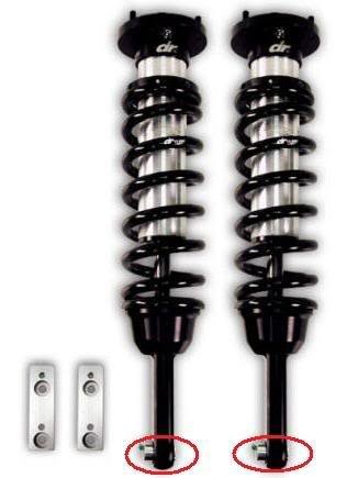

    Anyways installed the new icon coilovers yesterday however I cannot get my ride height even between the front passenger and front drivers side.
    The Icons say not not to expose more than 2'' of thread
    Front drivers side has 1 and 7/8inches of thread exposed and from the ground to the fender flare I am measuring 38.5"
    Passenger side has close to 1.5'' of exposed thread and I am measuring over 39" from the ground to the fender flar.
    Anyone have any insight? I cannot seem the get the drivers side up anymore and if I keep cranking down the passenger side it just seems weird to have a 1/2 inch difference in thread exposure and the more exposed side is sitting lower when it is supposed to be higher.

    I recall having to confirm how to install a spacer on the bottom mount of each coilover, the thicker spacer had to be towards the front. If you reversed the spacer on 1 side, I could see that potentially causing some ride height differences on that side. I can't find my notes or instructions, but I did just take a look to see the thicker spacer towards the front on each co.

    It may be the rear springs... Have you had the TSB done...? Allot of people complain of having uneven trucks due to the rear- no matter what you do to the front the rear will counter!

    maybe a dumb question but r u adjusting them with a load(truck on ground) or with load off?my foxs say to adjust with no load on them.dont know if they all r like that.

    Adjust the springs with both the tires off the ground. You will never be able to get it right with them on the ground.
