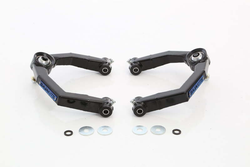

    JT@Bajakits
    JT@Bajakits Well-Known Member Vendor
    Jan 26, 2016
    #176129
    607
    JT
    Race Trucks and Off Road Suspension
    I can get definitely get you taken care of with Kings and our Boxed UCA! :)
