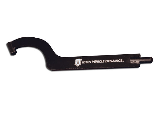

    Looks like that T-Handle tool is for adjusting King coilovers. That would work, but I don't know if the collar holes are the same diameter between the King's and the SAW's.
    Also, found this Icon wrench that has a stud on the handle end as well. But again, don't know if the hole diameters are the same between brands.

    I found an actual SAW spanner wrench online that is similar to the Icon one posted above with the pin on the handle end as well. Ordered it and will be giving it a try. Hopefully that does the trick; not quite what I was looking for but should do that same thing.

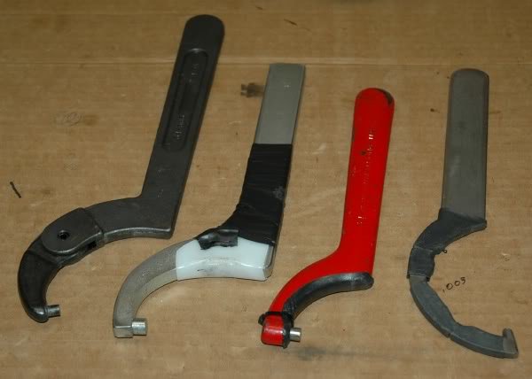

    No doubt 1st gens have limited access on the truck. In the past folks have gotten away using drill bits, sometimes 2 at once (shank end in collar). My spanner "collection" has different length arcs so at any point at least one will yield enough turn to allow another to fit. Still, slow going.
