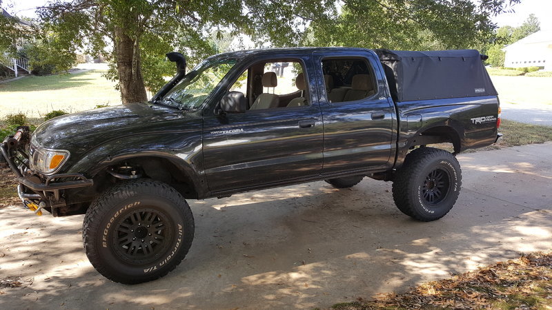

    1 owner 2002 TRD, SR5, DC, 2.7. Full OME suspension, STT pro's.
    OME 881 coils with OME nitrochargers shocks up front. TC UCA's OME Dakars with extra leaf in the rear. Warn 8000 winch with 80ft custom braided synth line. Custom 60ft synth extension. All pro tube bumper, Hi-lift jack, Safari Snorkel, Wilco tiregate. 2019 Jeep JLUR.
    Your 881's look worn out. I have new ones with nitrocharger shocks up front and have room for 35's.

    Do I spy total chaos UCAs?

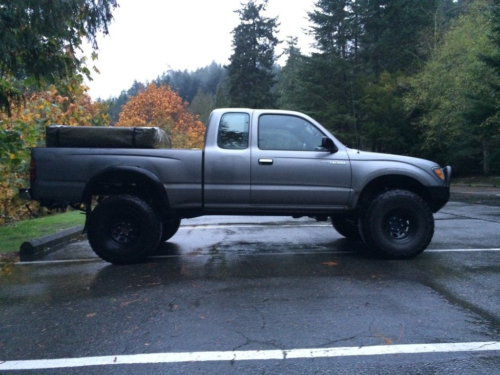

    I currently have SAW 2.0s with 650# 14" coils on my 99 2.7L extended cab Prerunner. They definitely feel too stiff for my setup. I am looking into getting some 500# or 550# coils to replace my current ones. I do not have anything extra on the front end.

    Sorry, to dissapoint you. Already test fitted the fronts with minor scrub, right side reverse.

    Nah. No way your fitting 35s without tubbing.
