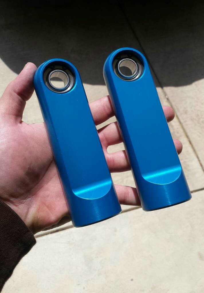

    Hey guys and girls, I am hoping that you can help me with information regarding extended rod ends or shaft spacers for my coilovers.
    I currently have a mid travel set up with King coilovers, and I have just added Allpro leafs in the back which have provided 4" of lift in the rear and now my front is nose diving so I need to adjust my coilovers. I am about to add a plate bumper, so given that my Kings can only provide 3" of lift once fully extended, I was wondering if it is possible to extended the rod ends or add a shaft spacer? I see that they have different sizes rod ends so I was thinking that if I added a 2" end and left the coilovers where they are, I would be able to obtain the lift I want without having to adjust all the way up.
    Has anyone got experience doing this? I have reached out to King but have yet to hear back and would like to get it done relatively soon if this is a possible solution. I have also see shaft spacers, but they do not look at sturdy.
    My rod ends are the short ones, but I saw these when searching online. I was thinking 2" ones if possible
    Any information would be greatly appreciated.
    Thank you!

    You need a heavier rate spring and then probably a shock revalve.

    Wouldn’t the shock extenders just reduce down travel even more and further angle the CVs.
    The rear should settle. I would look at swapping coils for a heavier spring to compensate for the weight. After all the coil is what holds the truck up.

    That is my fear. Once I add a bumper and winch I am going to be going back down to where I am at now by maxing out my coilover, which I really want to avoid doing. That is why I was thinking that if I had a solid inch or two extra, I wouldn't have to adjust my coilovers. Also, I do have aftermarket uniball control arms, but I don't want to lose travel either.

    While I don’t have the same gen, standard coil weights could not handle front plate bumper and skids. I uped my coils to 700# and truck sits the way it should and performs significantly better.
    I think upgrading your coils will give you much better performance over shock extenders.

    The spacer can push the suspension arms and ball joints further than designed. The uniball arms are your friend, good to have. More spring rate for more weight. You don't need Lt, just saying I have similar issue.

    So my best bet is to up the spring rating and adjust the coils higher to achieve the lift that I am looking for?

    Yup. My kings are adjusted to 2.75 inches and I’m running 700# Springs. I’m assuming yours is running 600# Springs.

    You can lengthen the shocks or add spacer within reason, I think with stock length arms I'm just under 3" with 2" of droop which is just enough.. I'm running a 1/4" spacer on the drivers side to even out the front. I could see adding up to another 1/4" on both, but more than that I think you would need a heavier spring... But I have the FOX shocks and I know they are longer than stock.
    I have the FOX DSC with std springs with a stock bumper and almost 3" lift and it's great running at the dunes, If I add a bumper/winch I think I will need heavier springs, it will be too soft...
    If you crank the springs down too tight they will bind...
