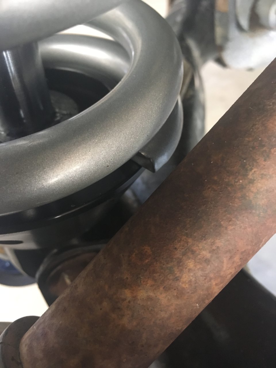

    @ThatRedYota
    I'm installing the same coilovers on my 99 4x4 and had the same issue, rotated the spring so the end of the spring was positioned towards axle and it just clears the cv... (see photo)
    Maybe the guy already figured it out but someone might find this helpful in the future.
    Or if he had the misalignment spacers backwards that would do it. Larger spacer should be to the back.
