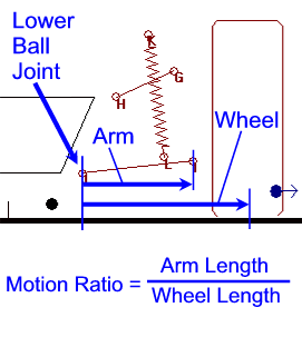

    I don't think you can have this discussion without wheel rate; given that many that lift will use spacers or high offset wheels.
    Wheel rate=spring rate x motion ratio^2.
    Moving the tire out decreases the motion ratio.
    Motion ratio is also suspension travel vs wheel travel.
    0.8 motion means 0.8" suspension travel vs 1" wheel travel.
    As an example, a 1.5" wheel spacer reduces the motion ratio by about 0.1 and reduces the wheel rate by about 10 lbs.

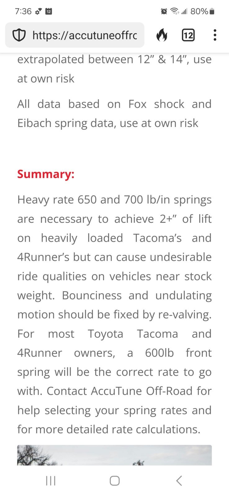

    I have read Accutunes suspension articles many times over, including the fine print max preload setting below each example and summary from this article.
    I believe the relationship of longer 15" to near 16" length coils from Dobinsons and OME, is to approximate/mimic preload settings.
    I am not aware that either offers a mid- spring rate option, only 586-590#, straight to 700+#.

    I’ve read those articles as well. IMO I think anyone with questions should contact @AccuTune Offroad or any other vendors that offer great advice on set ups. For me I’m 1000 lbs over stock with full steel armor , front bumper , winch etc. Why when talking with Accutune I went with 700lb coils on my kings. I’m super happy with set up.

    I‘ve read those articles before they don’t give definitive answer. Everything varies from truck to truck depending on etc.
    So I guess I just need to go ahead and see what happens and I’m going to try 14” 600lb/in springs as Accutune declares that I can get up to 2 5/8” preload on those. Also I don’t run any extra weight in the front except the LED bar but it always nice to have some room in case I decide to add equipment. Thanks everyone

    I'd go with Accutune's rec on your Fox for sure. They are dialed in tight.

    What makes you think your Fox 2.5s are maxed out?
    How much added weight do you have up front over stock?
    Ride quality will come with proper spring rate and valving. We definitely need to get the correct spring on there first, then we would typically revalve the shocks to work the best with that rate and vehicle.
