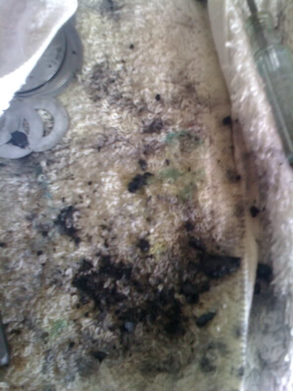

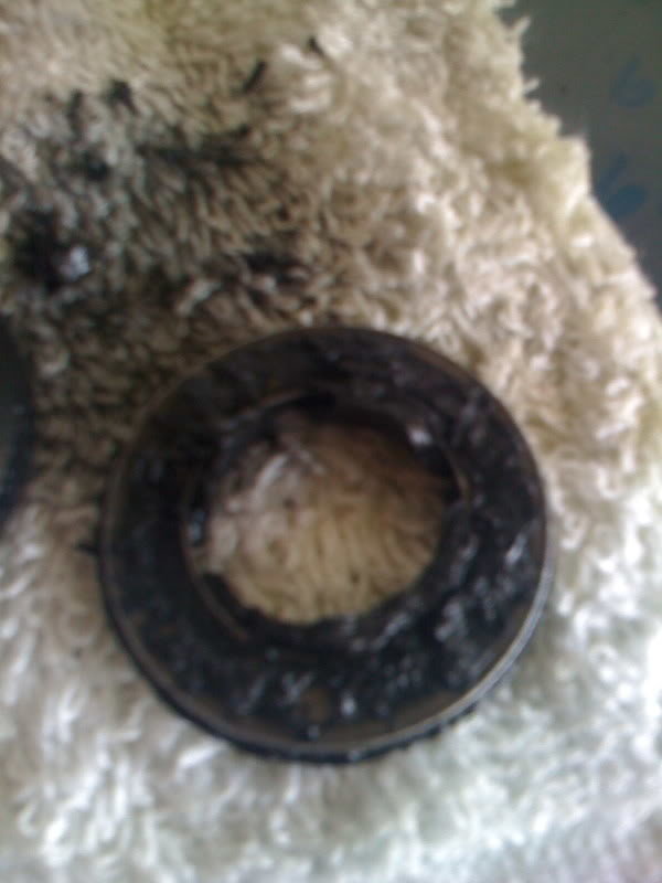

    So i dropped my coilovers off to sonny at downsouthmotorsports.com and he helped me out by rebuilding the coilover it took a 2 day turnaround one of my shocks was in bad shape with all kinds of plastic inside at one point sonny had to heat it up witha torch to get the plastic out the plastic clogged up the holes allowing the shock not to work properly so everything was cleared and sonny rebuilt it and he was actually shocked to see how bad it was inside im just glad it wasnt that bad it could have let to even a bigger matter heres some pics of what i am actually talking about.
    This is the retaining washer suppose to be one solid peace

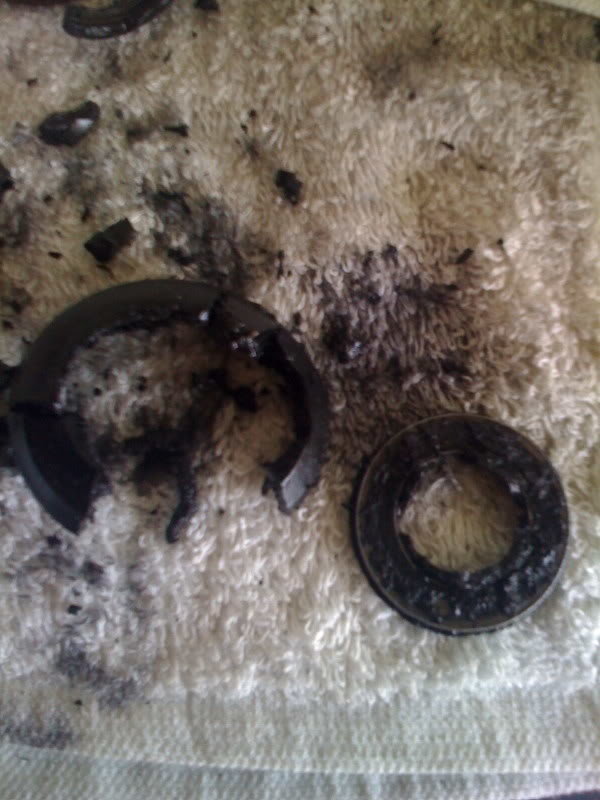

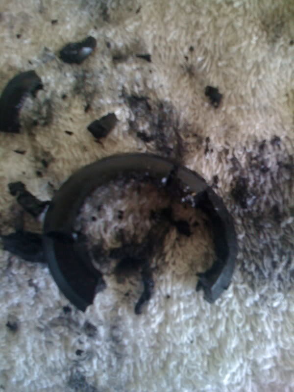

    this is the washer your not even suppose to see the metal lol
    All the black rubber pieces through out the shock
    Another pic

    If you guys are looking for a rebuild in your coilovers Hit up sonny at downsouth motorsports its a quick turn around he kept me informed what was going on and if i need to purchase some pieces or if there was further damage, so he is on top of things he knows what is doing especially with 20+ years under his belt, i will tell you this when he test drove the truck with the coilovers he hit in on the nose and knew exactly what was wrong and sure enough it was the picture tells the story.

    I dont think I have seen worse looking internals on a shock!

    Those parts look beyond toast, really can't believe the guy didn't notice problems running something so busted up.
    glad Sonny was able to fix you up

    No no....The dud e that sold those KNEW there was a problem. NO WAY you can drive on those and NOT know it. And they dont self destruct like that off of a vehicle.

    The coilovers were in bad shape....But nothing is beyond repair..Most of the
    time, HA, HA, HA:)
    That washer you see in the picture is actually part of a vulcanized rubber top out
    bumper that goes between the seal head and the aluminum spacer before the valve stack washer.All the bleed holes in the piston were clogged with the broken pieces of
    rubber to the point where I had to heat up the piston with a map gas torch and
    push the hot rubber through the holes so the fluid would flow through it..
    All the seals were changed and of course the oil and and I had to flush out the cylinder and reservoir line with 99% alcohol and then a little bit of clean shock oil..
    It went back together a lot easier then it came apart....
    There is a little lesson here for everyone and it is about King coilover shocks...
    I will of course stand behind any King Shock....But When the crew at King
    did the R&D for the OEM coilover replacement shocks ('05-'09 Tacoma),
    Lance said that it was designed for better performance on and off road and
    they were not designed to be a lift coilover.
    They are good for about 2" to 2.5" of lift (Ride Height) change and when they get cranked to high, well as you can see in the pictures over time, they get a little hammered...
