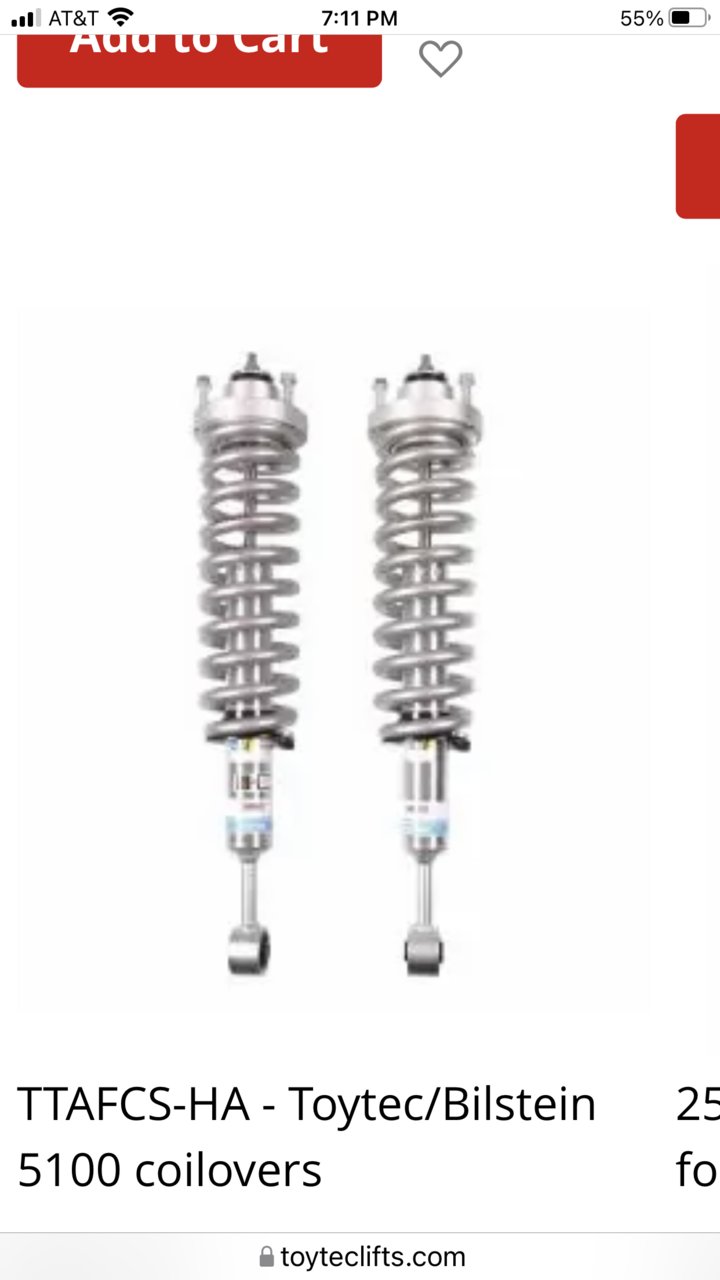

    Just get the Toytec coil overs. They use 5100s and eibach coils set at 0. You’ll get 2.5-3” of lift. They come preassembled.

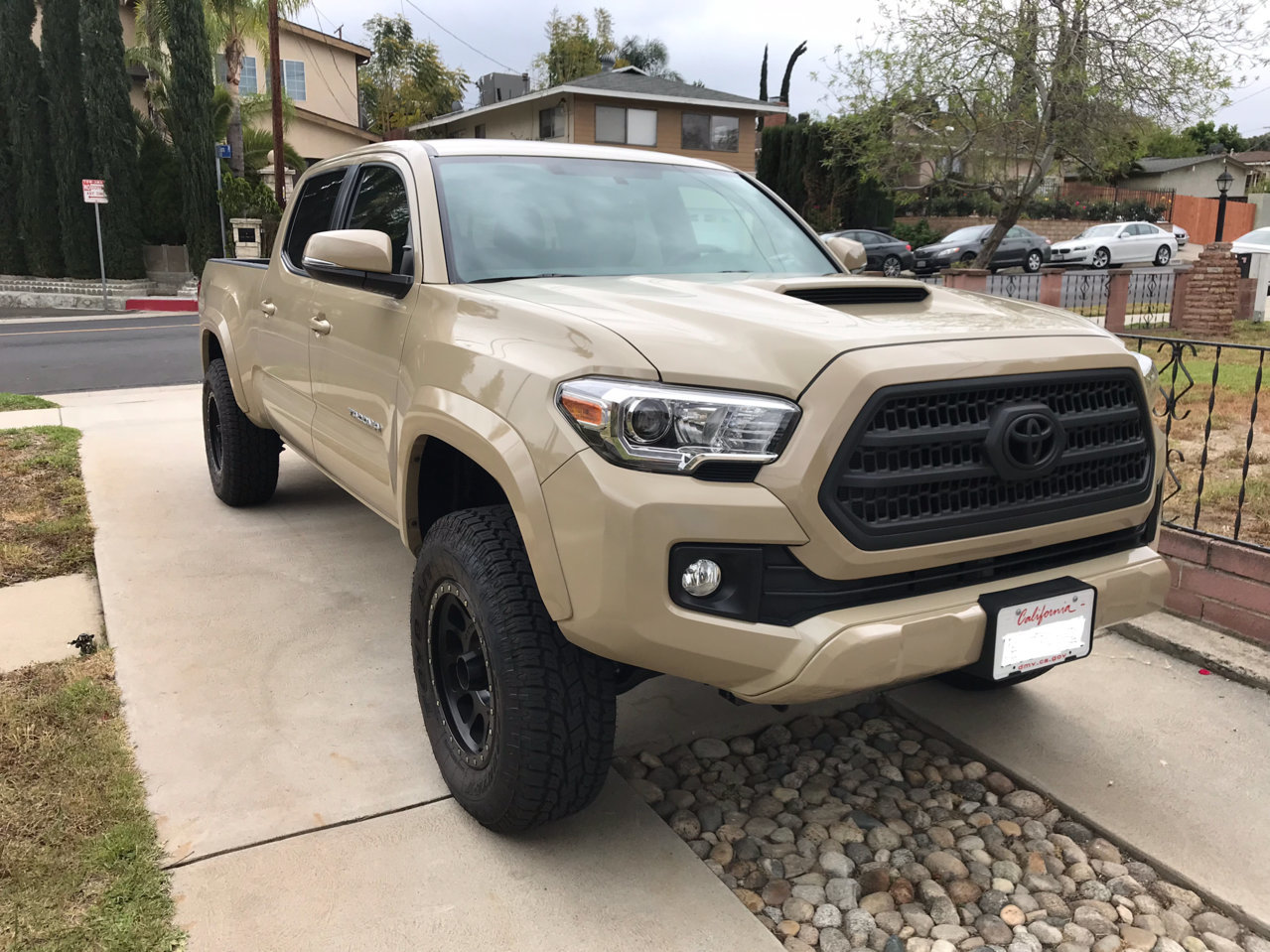

    I depends on the trim , 4wd , 2wd , long bed , short bed . I have 2wd long bed , gained after settling , 1” . 21204FD9-C79A-46A7-8727-15F3F6B86C47.jpg ( 5100, with 884 ome coils )

    im a DC 2wd short bed. Do you think I’m better off going with the 885’s w/5100’s on the stock setting. Ideally I’d like 1.75 inches but don’t want anything over 2 inches. Tire size will be 265/70r17 wheel 8.5 width zero offset
  14. Nov 27, 2021 at 4:06 PM
    Rivermaniac
    Rivermaniac Well-Known Member
    May 24, 2017
    #219805
    178
    I would go with 885 springs and 1” block in rear , if you want to keep the factory rake , then an add a leaf , 1.5 inches in rear . The picture above has nothing in rear . From ground to fender 37” all around . From hub to fender 22” all around . Tires are 265/70/17 17x8.8 , 0 offset .

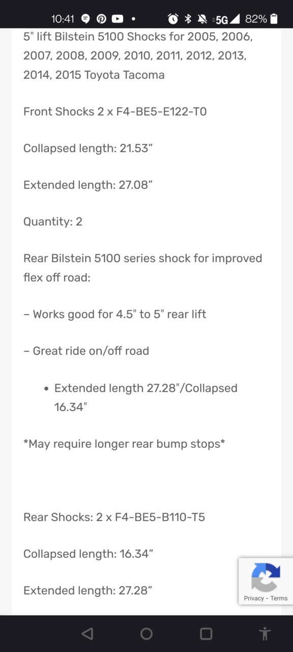

    I'm in search of longer coils for a 4-5" lift, my truck has the drop bracket for the front and a 4" measured spacer on top of the factory coilover. I'm replacing the rear factory spring with the 4" lift block, to a set of Robinsons med leaf packs and a 2" block so I've got that one figured out. Bilsteinlifts web site has a set of 5100 extended travel front and rear. The set requires a longer coil and I'm not sure what to get or where to look.

    5100’s are designed to use the factory coils. Your best bet would be to use the 5100’s on the bottom clip and retain the supplied lift spacer that goes on top of the strut or buy longer shocks and springs that are designed to work with a 4” drop bracket lift. I believe AccuTune Offroad has a Fox option specifically for that application.

    According to this... These 5100s for the front apear longer
