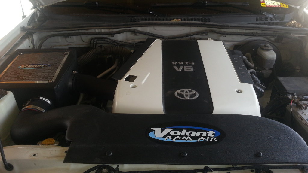

    I have the AFE Stage 2 SI setup with a volant scoop. Keeps the intake temps alot cooler :thumbsup:

    I have a Volant setup that I bought from a member on here. I like it :D

    The volant has been the one I have been looking at...any feedback?
