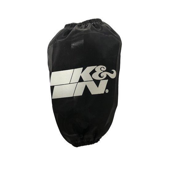

    i put a dust/water filter on the intake when i know im going somewhere dusty. it probably restricts airflow but i dont need a crazy amount of power when im somewhere dusty really. easy to wash and keeps filter cleaner for longer.

    forgot the picture but something like this

    Thats a good "Band-Aid", but the filter "sock" they offer simply blocks the larger stuff that the filter would have caught. It doesnt stop the fine particles from entering your engine.
