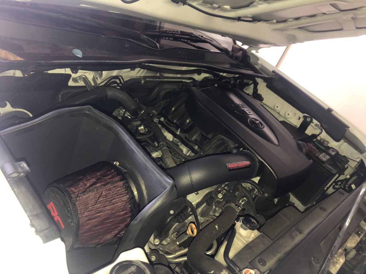

    Went this route.

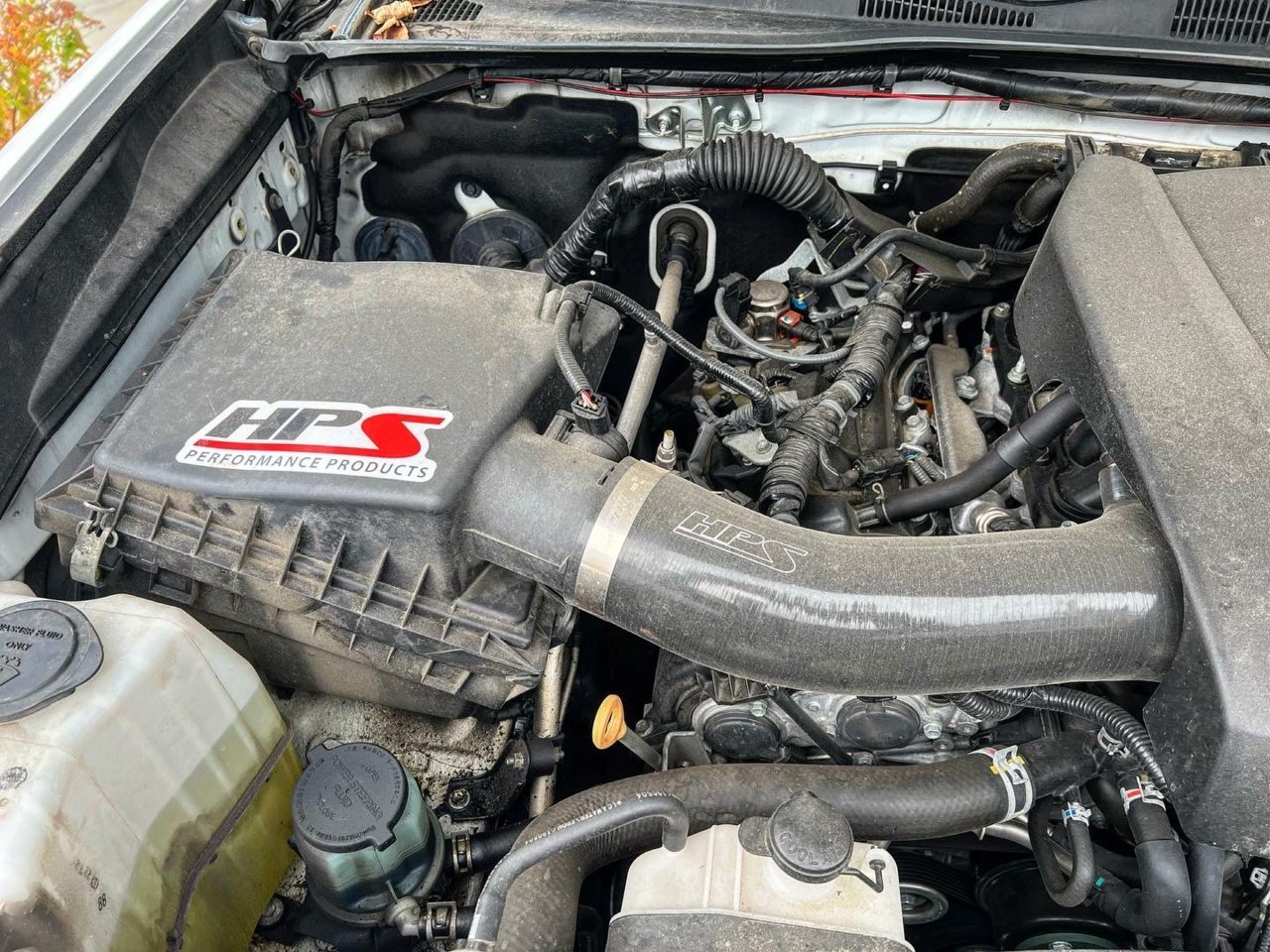

    That’s a hot air intake. Return it if you can. I’ve used those on previous vehicles and had a bad experience. Got worse mileage. If it’s an oil filter it can gum up the MAF sensor. There’s no benefit to them.
    If you’re looking for something flashy these HPS intake tubes come in blue and red. I bought the black one. It eliminates the resonator on the factory intake tube. HPS claims there’s an increase in horsepower. What I’ve noticed is reduced pedal lag, quicker acceleration and improved mileage. I have it paired with an OTT9 tune. It sounds pretty awesome when you hit over 4,000 rpm too. Plus the MAF sensor is not relocated. It doesn’t mess with the air to fuel ratio that alot of these other aftermarket intakes do (moved the MAF closer to the intake).

    also did this, great combo except with the snorkel and no fender liners it is LOUD but I like it especially when it pulls hard around 3-4000rpms uphill. Yea buddy
