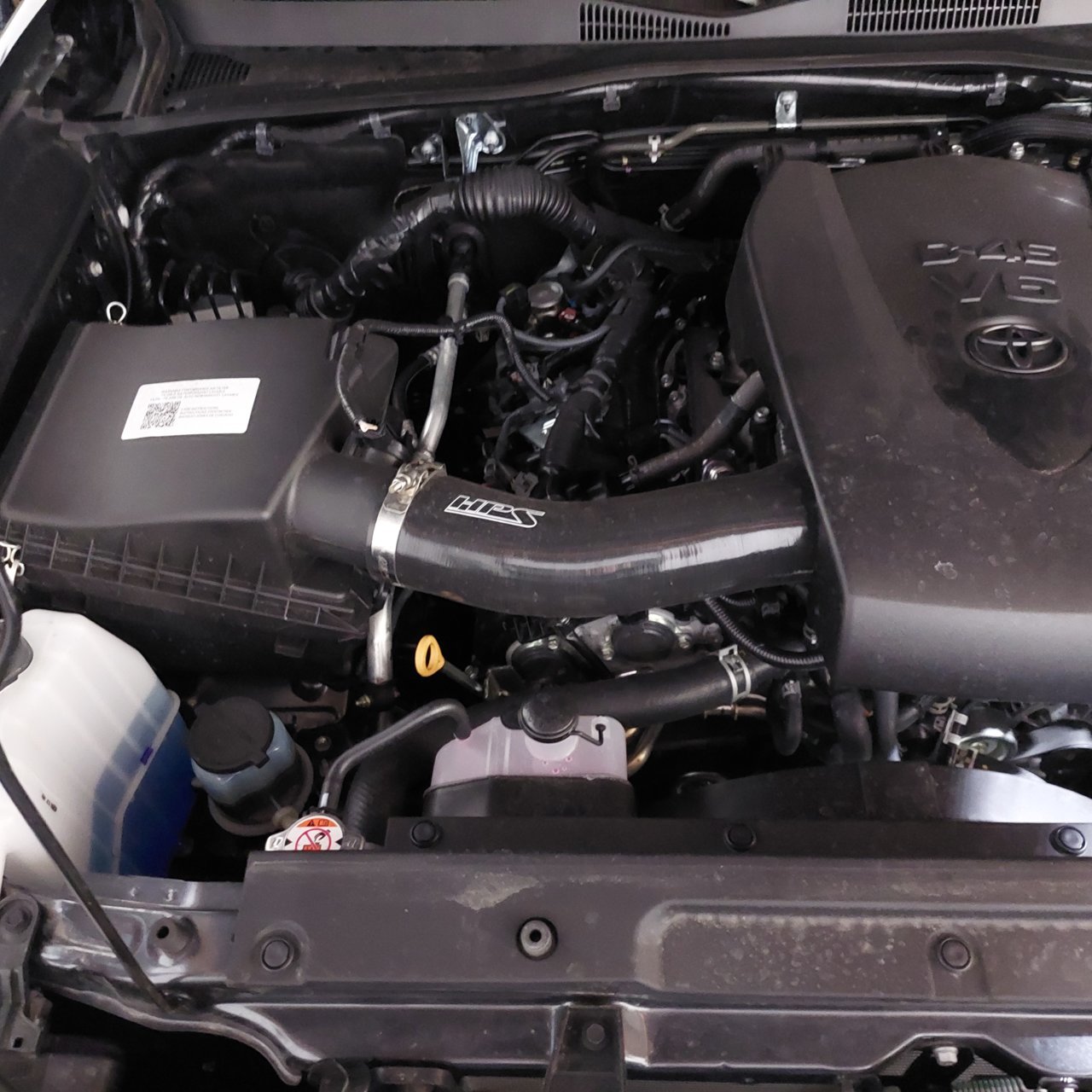

    Here's my setup..... Works great and I left the charcoal filter in also. It will snort around 3500 - 4000 rpm.
    HPS
    TRD Oil filter

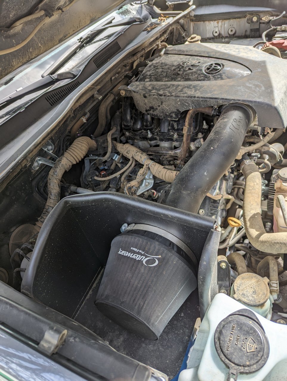

    This is my setup. k&n intake. You get what you paid for I guess

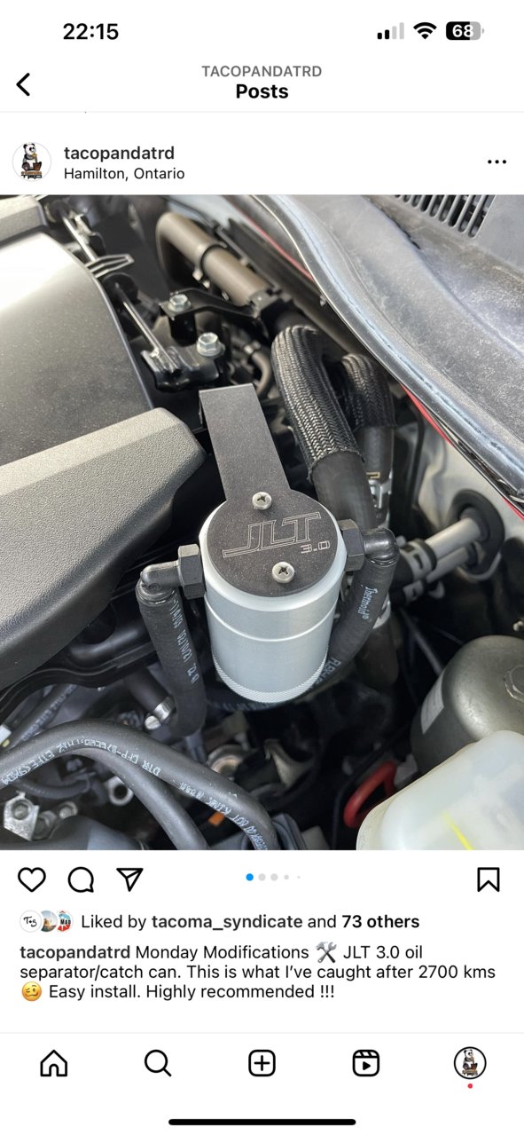

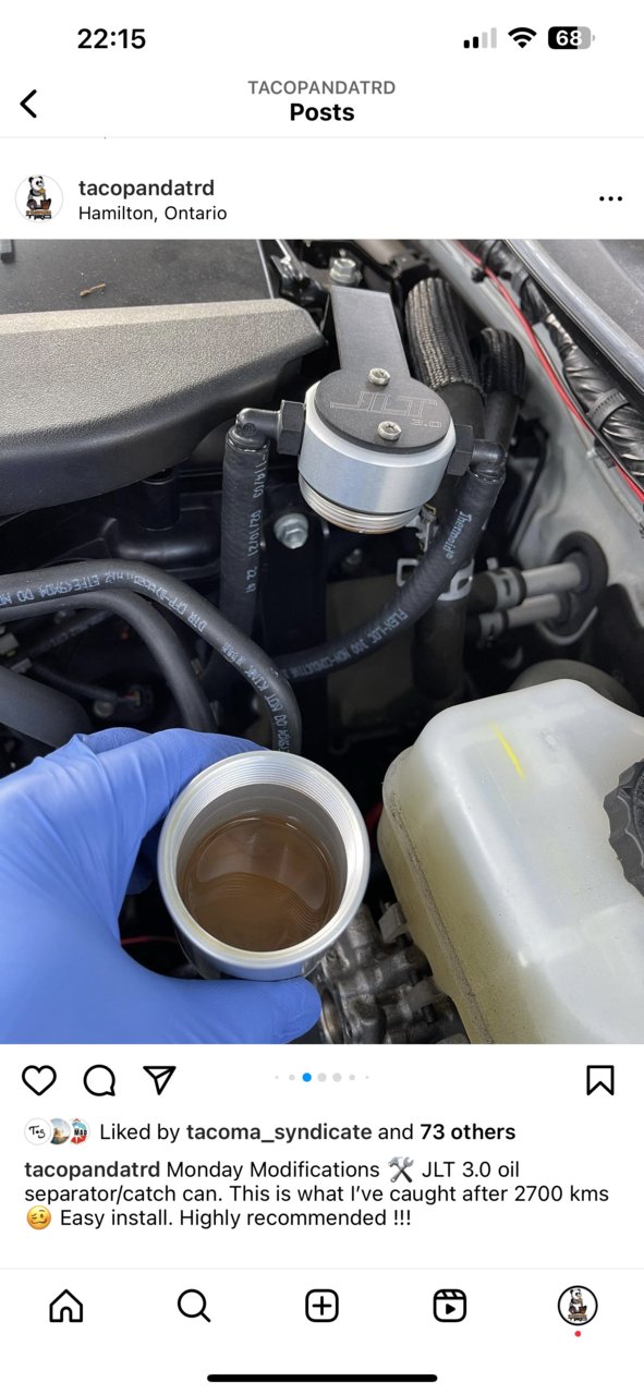

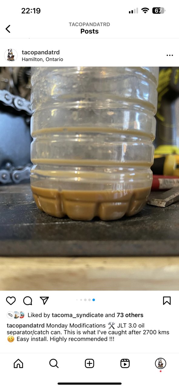

    Oil separator (aka. catch can) main purpose has nothing to do with using an oiled filter. I guess it could catch some of that oil but most of it will be burnt off inside the combustion chamber.
    To see if you over oiled your filter take the intake tube off and look inside. You’ll have oil slick everywhere and your MAF sensor and throttle body should be covered in oil too. The job of an oil separator is to catch and filter out the blow-by vapour gases and moisture that are from your engine oil from inside the crankcase that blow past your piston rings. With no oil separator in the return hose it sends these gases and other nasty stuff back into the intake manifold to be burned off, unfortunately leading to your throttle body getting gummed up. Oil separators will allow your engine to run cleaner and get better MPG.
    I have a J&L kit on mine. Biggest benefit I know for running one on a 3rd Gen Tacoma is that on steep climbs the oil displacement floods to the back of the engine. It will stop oil starvation and not flood the throttle body by sucking all the oil through the return hose.
    After having it installed for only 2700 kms (1677 miles) this is what I had in my canister. I doubt anyone would want that recirculating back through their engine. If you did have an over oiled filter maybe you would have caught even more in the can? Who knows.
