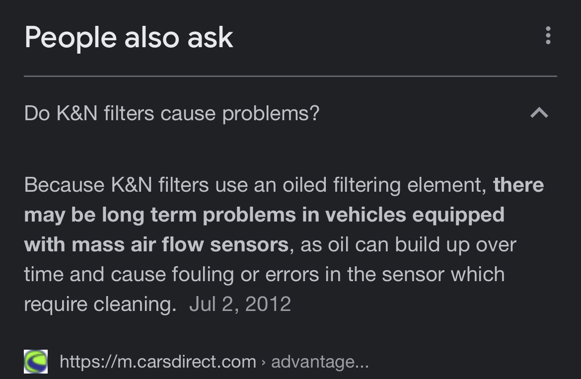

    So someone drops in an air filter, car has problems and now they are dumb?
    It’s on Google so it must be facts.
