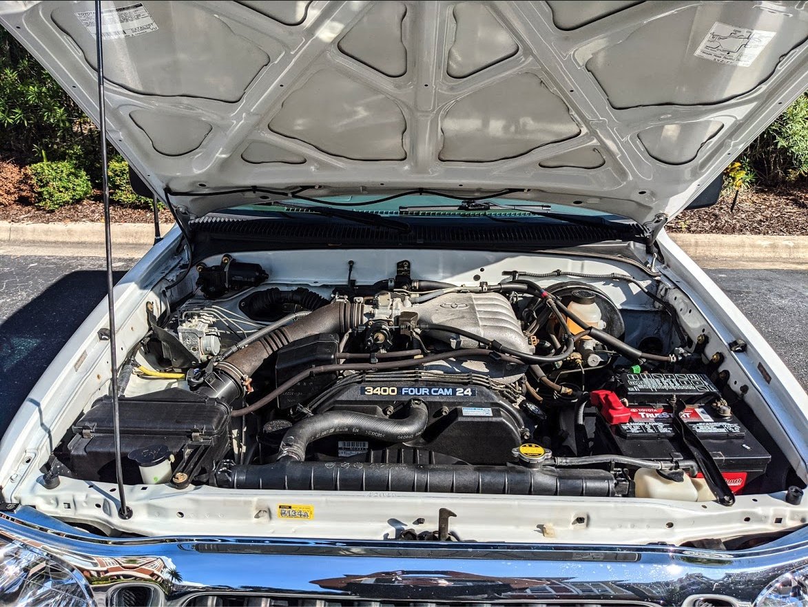

    Hi Everyone, new to the forum. I am a new 1st Gen Tacoma owner (2003 V6 4WD Auto Xtra Cab) and several people have told me that adding an aftermarket cold air intake is well worth it while others have said, not so much. Any real use case thumbs up or thumbs down input? Appreciate it!
    Here's what I look like under the hood.

    The factory intake is cold air.

    Thanks, yes the factory one is a Cold Air Intake, I was told the aftermarket ones allow for more air "Volume" intake than the factory intake and thus better performance.

    A bigger volume intake doesn't force more air into to the engine, only way to do that is with a turbo or supercharger.
    Most cold air intakes actually pull in warmer air than the stock intake. If you want an intake that pulls in 'cooler' air then get a snorkel. Snorkels pull air from well outside the engine bay and high up from the ground so it's actually ambient temperature. Rather than warmer air from closer to the ground or from inside the engine bay

    When I had a first gen I just did the deck plate mod with an AFe drop in filter for the stock air box.
    Just don’t do a short ram or open ‘cold air intake’ that’s just a filter in the engine bay, nothing about it would be ‘cold’ air.

    x2. When I bought my truck, it had a K&N on it. The filter pulled hot air directly from under the hood, no gain of power at all. Anything like that isn't a true CAI. It also sounded absolutely awful, especially at highway speed (high pitched sucking!), had to drive slower just to hear myself think. Put the factory box back on and I am perfectly happy.
    I know that Underdog Racing Development makes a "true" CAI that pulls air from in front of the radiator, they claim that when driving the air is 30°F cooler than the stock intake. Might check to see if they have one that fits your truck, but I've heard that they require cutting for fitment, not a bolt-on mod.
