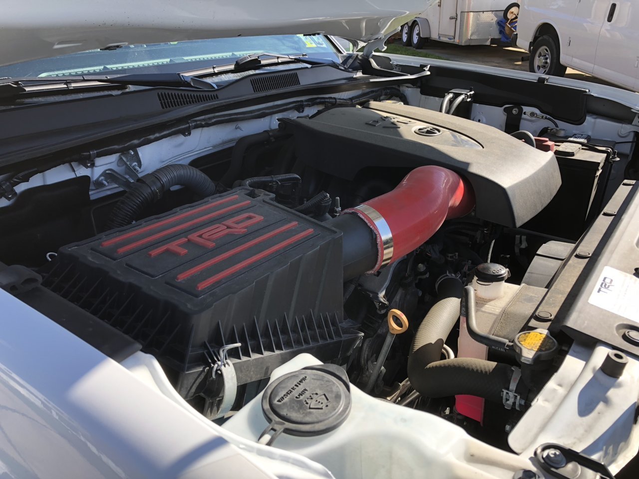

    The stock OEM air box is a cold air intake system! The stock setup pulls air from the inside of the passenger side fender well.
    S&B, Injen, TRD, etc as long as the air filter is enclosed and not open under the hood will give you butt Hp increase.
    BillsSR5 likes this.

    Ronzio
    Ronzio Well-Known Member
    Feb 20, 2018
    #245114
    2,719
    Pennsylvania
    17 DCSB TRDOR

    Is that the HPS silicone coupling? Also did you just buy the TRD air box lid? Had that exact idea

    I have the complete TRD CAI and just swapped the HPS (57-1600) in place of the intake tube...the TRD CAI air box lid is larger than stock so the HPS tube needs to be trimmed 3/4 to 1 inch on the end to fit cherry.
