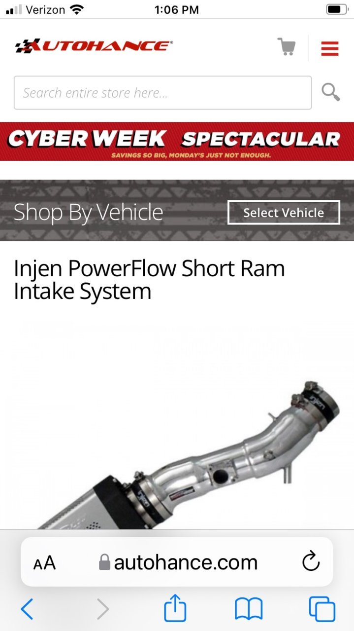

    Hey guys. Looking to buy this short ram intake by Injen. Anyone running one on their 2nd gen tacomas? Hp/ Torque gains? Mpg gain? Sound? Thanks.

    Your truck already has a better true cold air intake stock.
    Unless you like more noise, less power and less filtration, stick with stock.

    dyno chart shows 18hp and 16Ib torque more. I don’t quite understand what you mean. The stock air intake sits too close and open to the engine to be “cold”. It also has far more restrictions in the intake itself.
    I think the “noise” can sound good with a proper exhaust. Sounds more throaty in high rpms.

    Go take a look at where the stock air box pulls air from.
    I bet you’ll find it pulls it from the fender. Not the engine bay. :thumbsup:

    Stock intake pulls from outside of the engine bay all together.
    never... EVER trust dyno numbers from the company trying to sell their product. The only time the stock intake has been shown to not flow enough is in supercharged applications when smaller pulleys are used.
