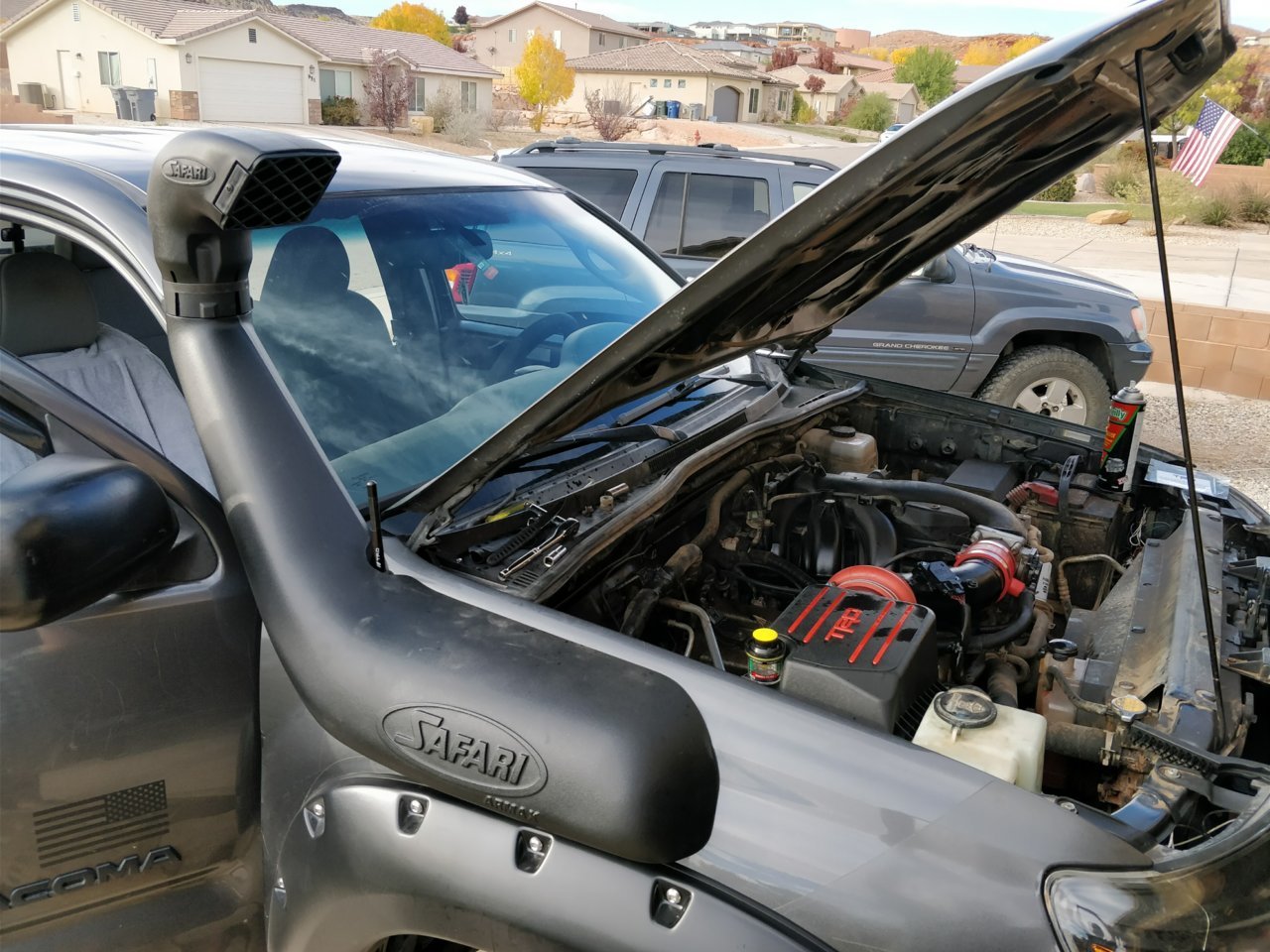

    Just finished installing the safari snorkel on my 2nd gen while installing I noticed a few things that might answer some questions.
    1st. You could dump a bottle of water or whatever down the snorkel and it probably won't do anything unless you were mashing on the throttle at the same time. There are 3 drainage holes in the stock air intake next to where it pulls the air from the fender designed to allow water to drain.
    2nd. snorkels aren't just for water crossing and cool looks they are actually common in the desert because it helps filter out sand and other dust particles in the air. I don't really know how to explain how it works but there are lots of diagrams online.
    3rd. A snorkel will actually RAM air into the intake while you drive down the road instead of having to pull the air from the fender giving you more air and cooler air from further away from the engine.
    4th. You can still run after market closed air intake systems with the snorkel. I will be purchasing an aftermarket intake and filter system to work with the safari snorkel so they will complement each other. The air will be rammed down the snorkel and through the aftermarket intake system then to the engine. (I'm really only doing this because I want to be able to hear that deep tone of the CAI every time I put my foot down).

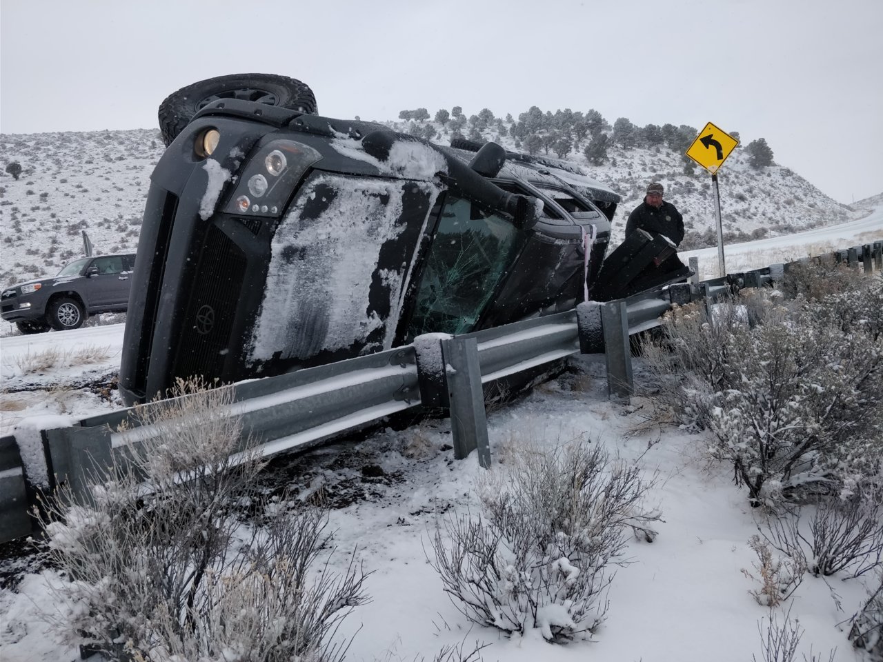

    I ended up using the TRD intake connected to the Safari Snorkel. It was beautiful right up until I flipped the truck on the highway ‍
