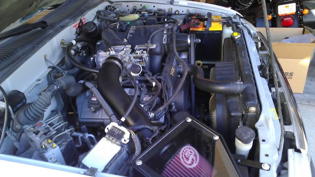

    I like my S&B, I prefer it over K&N for 2 reasons 1. it has an inclosed box with 2 openings vs just a heat shield & 2. they use an 8 layer filter vs K&N's 5 layer (probably not that big of deal on gas engines but I came from modded diesels & that was a major plus for them & how well the air got filtered with the massive ammoount of air diesels suck in) But that's just my opinion IMAG0470_zpscab75f24_531126dac8117c2c37b45d1def2e5bed2998a059.jpg

    Yeah, looks nice! Is that an oil or dry filter?

    Yeah looks almost the same as volant. Never heard of that one. Looks a little better actually. I like the clear lid. I thought about making a clear one for mine. But I'm actually gonna try making a custom cai out of volants custom kit they sell..
    It looks to be oiled too. Which volant is too. But again, powercore filters can be used on anything really. I suggest it. Dry filter. Absolutely no dust specs or anything in my intake.
    Edit: and I drive down a dirt road every single day twice.

    Mine is oiled, but they have dryflow filters also.

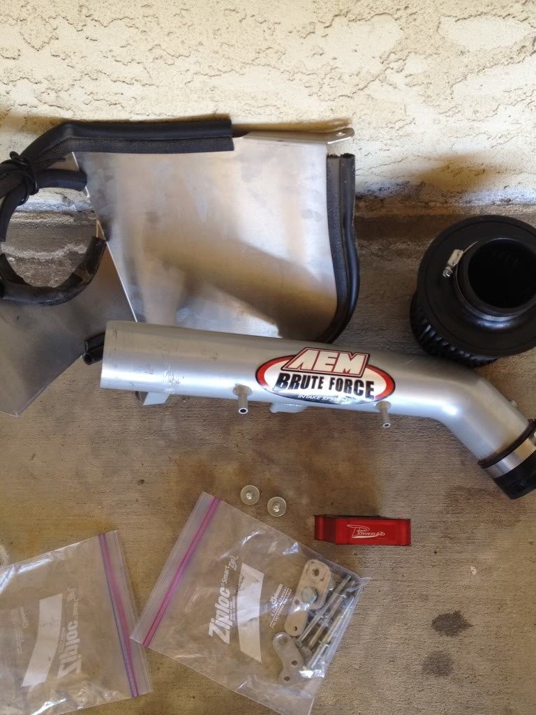

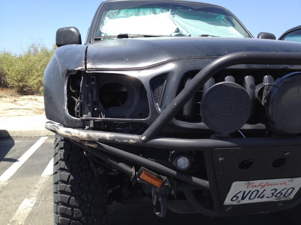

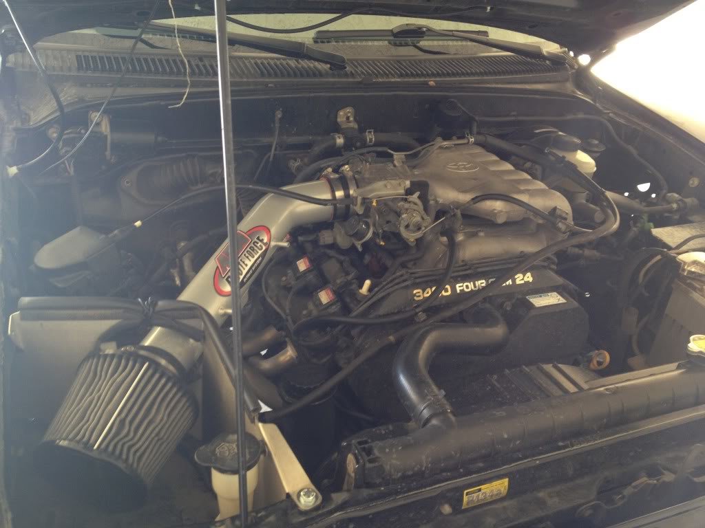

    Stock with deck plate is fine for daily driver and desert for me.
    However because I have compliment mods already done with Doug Thorley header, new cats and 24 inch magnaflow muffler exhaust having my AEM brute force on besides being louder gives me maybe 1 mpg better with very little but noticeable more power going up hills or hauling more weight in the bed or trailer.
    Deck plate: with elbow removed and side area closed off.
    High flow mod.. ricer style:
    AEM:has new filter since pic was taken
