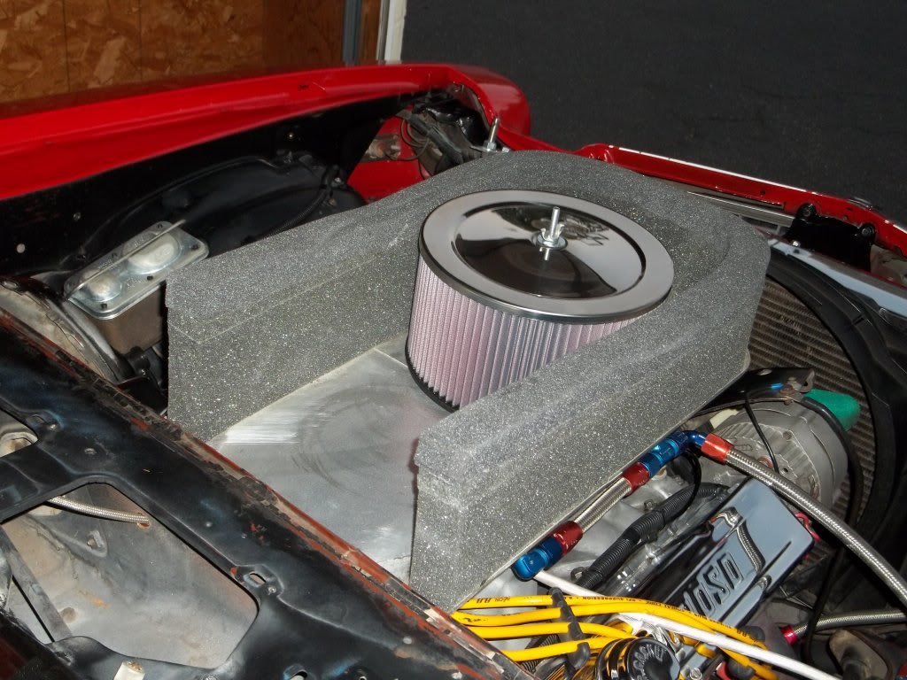

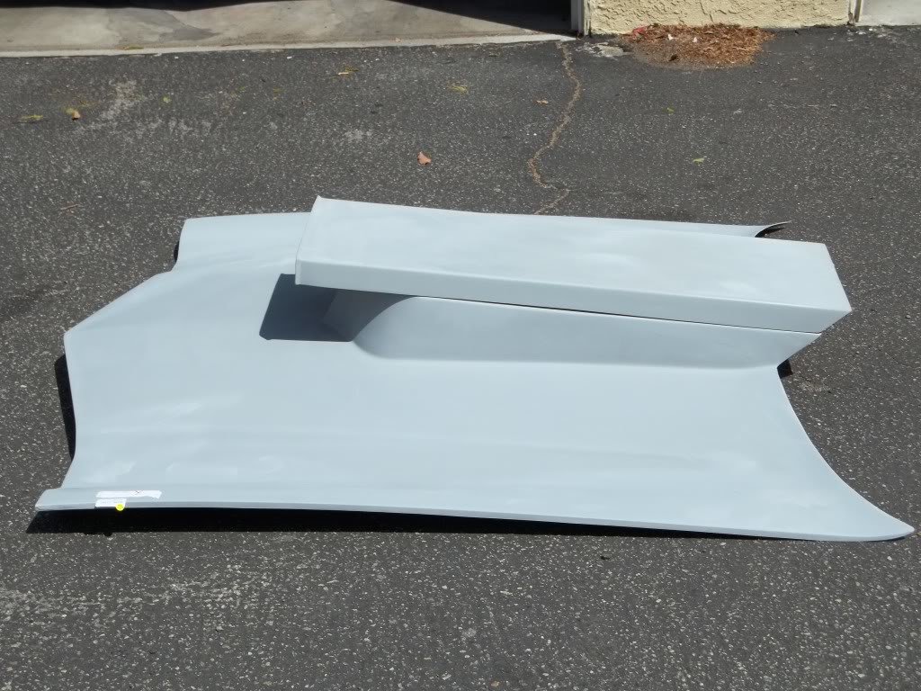

    Here's the best type of CAI and on my Camaro . Good for 3/10ths second reduction in ET and 7 mph in the 1/4

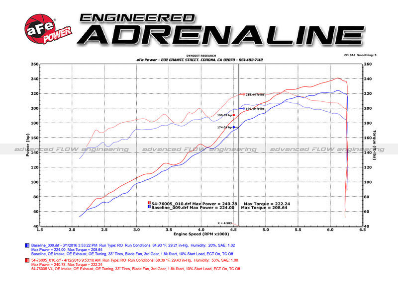

    Very nice gains for an intake. Props to AFE for doing the R&D. I will definitely keep my eyes out for first hand reviews!
