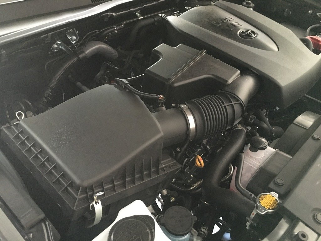

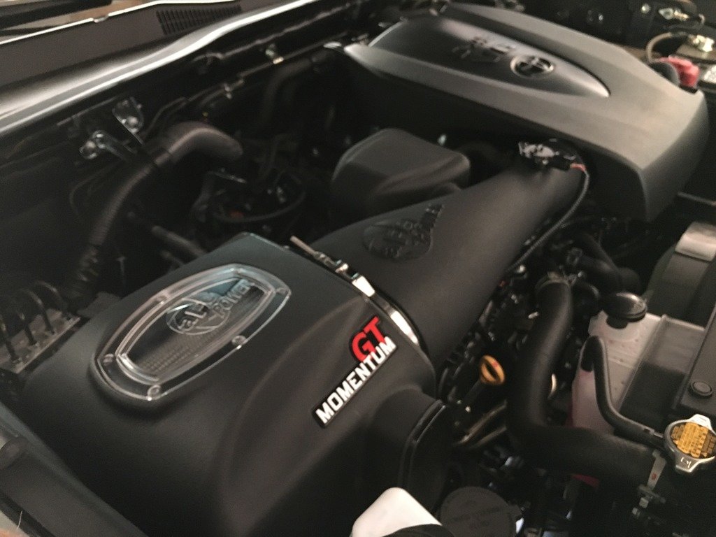

    Install was easy peasy!...
    Now if I can figure out how to post videos, I took before and after footage...
