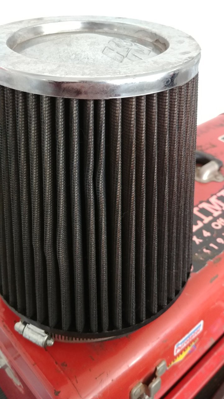

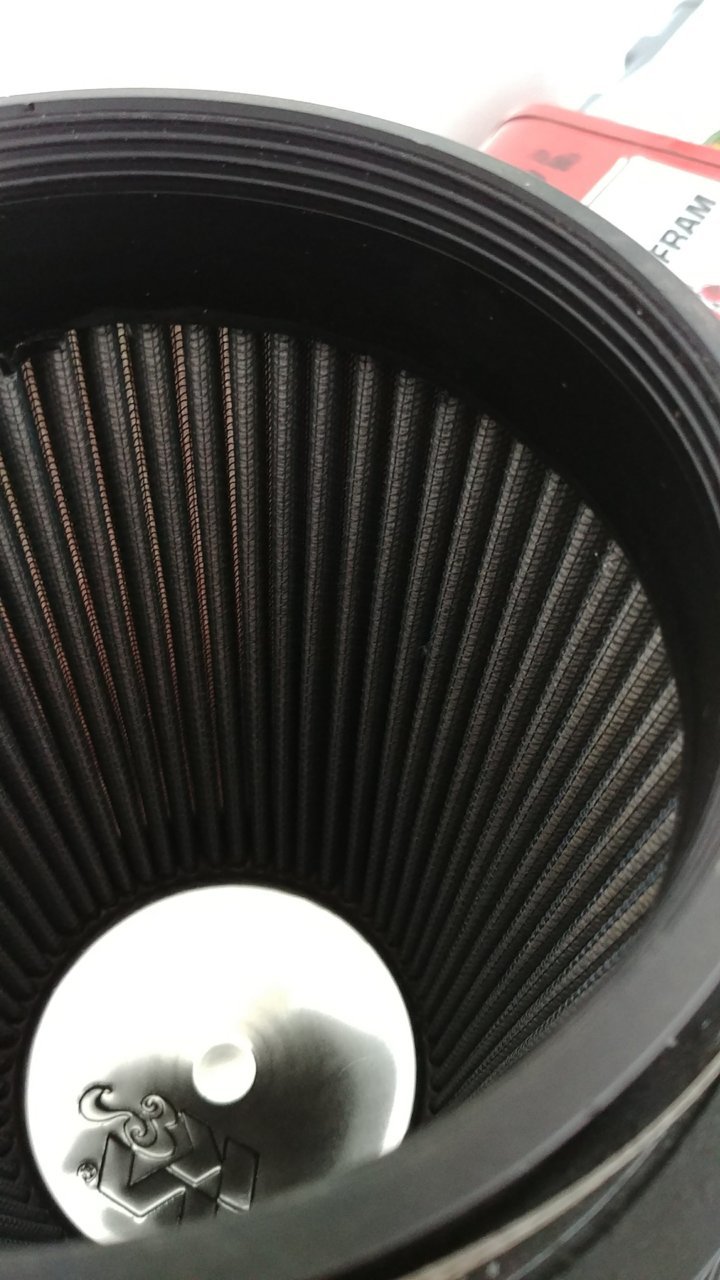

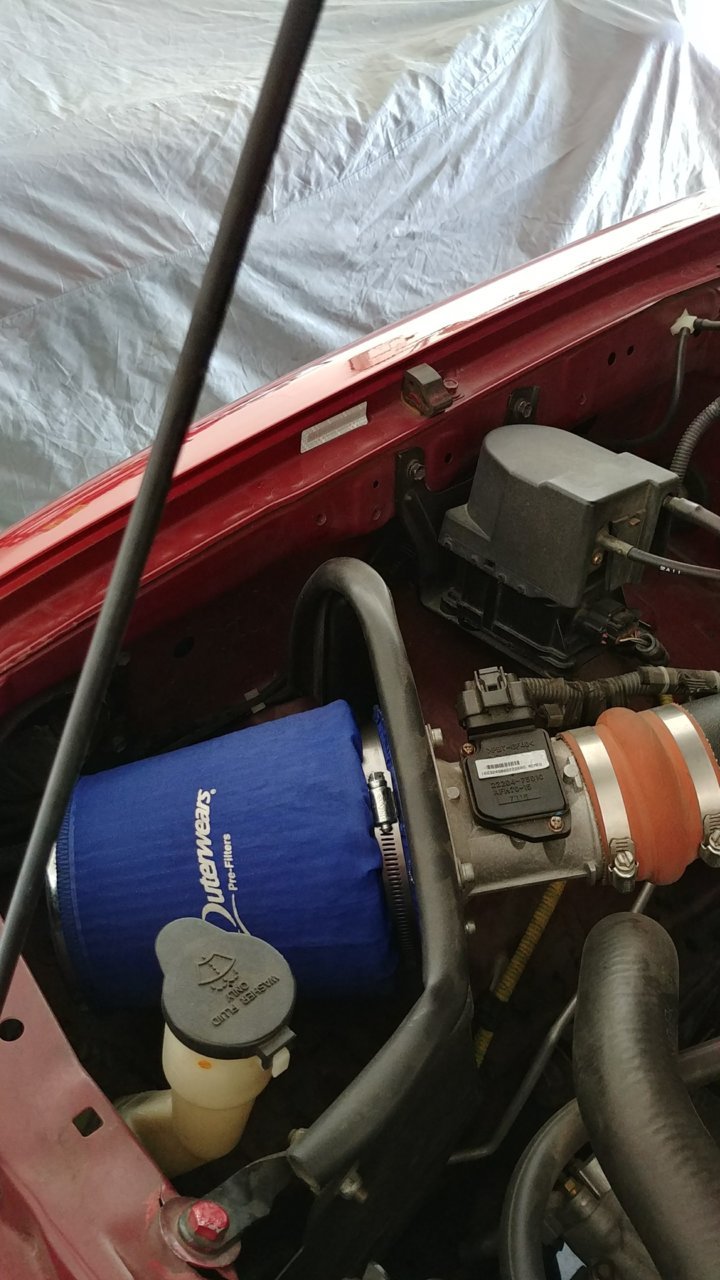

    On my 02 Tacoma Pre Runner which has a supercharged 2.7 4cyl I'm running a K&N FIPK which also has a K&N filter sock
    https://www.knfilters.com/mobile/mProduct.aspx?prod=RF-1037DR
    There is absolutely no dirt on the filter and inside the the intake tube no dirt build up that can affect the MAF
    Filter was replaced with maybe 5k miles on it for a clean filter . No dirt or sand noticed inside or outside of filter
  13. Apr 19, 2018 at 7:53 PM
    #193
    hiPSI
    hiPSI Laminar Flow
    May 21, 2017
    #219544
    12,121
    South Carolina
    2024 Long Tundra
    You have several good responses in this thread by people who know what's up. Unfortunately, most of the other posters have no earthly idea what they are talking about. My above post is as factual as you are going to get, and it applies to all modern engines, not just the Taco.
    You are going to get a bit more power at WOT. Nowhere else in the curve. That's it. You will not get as good filtration. That's fact. If you feel the trade off is worth it to you, by all means, enjoy the filter. I wouldn't bother with dyno runs though. 10-20 hp is well within the margin of error of the dyno so the results you get may or may not be realistic.
    What you are attempting to do is akin to measuring a shaft tolerance of + - .0002 with a tape measure lol.
    inksin, US Marine and shakerhood like this.

  15. Apr 19, 2018 at 8:15 PM
    #195
    hiPSI
    hiPSI Laminar Flow
    May 21, 2017
    #219544
    12,121
    South Carolina
    2024 Long Tundra
    I've read your posts and they are spot on. I appreciate the knowledge you bring here.
    Don't get lulled into a false sense of security with visual inspections of the sock or filter though.
    Human hair diameter is around 45 microns, which is close to the limit of the himan eye.
    Wall to piston clearance is around 5-7 microns and half of that is gonna be oil film.
    Normal bacteria is about 3 microns lol.
    You are not going to see the particles that can damage your engine with the naked eye on the filter. You need about a 20X microscope just to see the speck. It takes a LOT of this size particles just to get a minor discoloration, much less seeing a particle!
    Again, i appreciate your posts!
