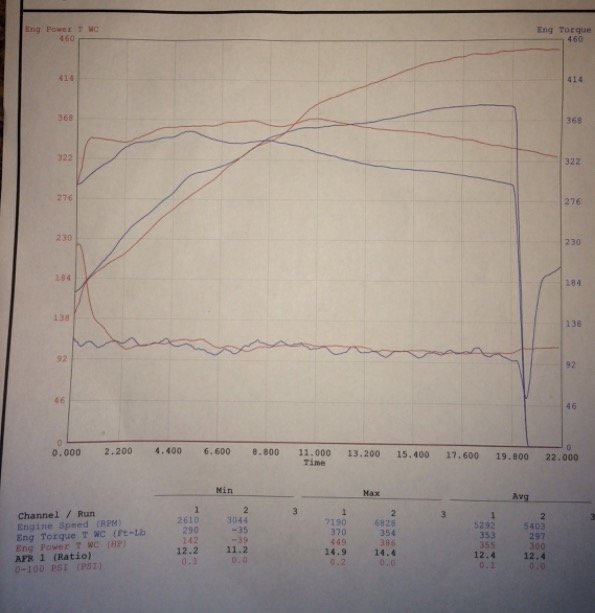

    The beauty of breathing mods working in conjunction with a proper tune
    Obviously not a Taco
    Before it had
    CAI, test pipes (Cat deletes ), was custom tune for 93 already
    After
    Intake Manifold, throttle body, CAI (larger diameter and element for new throttle), LT headers and custom tune for 93
    For me a CAI alone is good for engine sound.

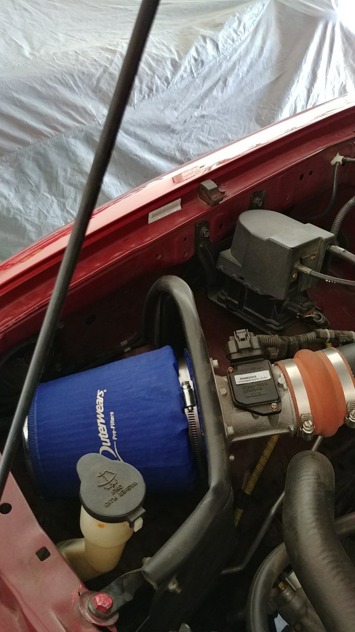

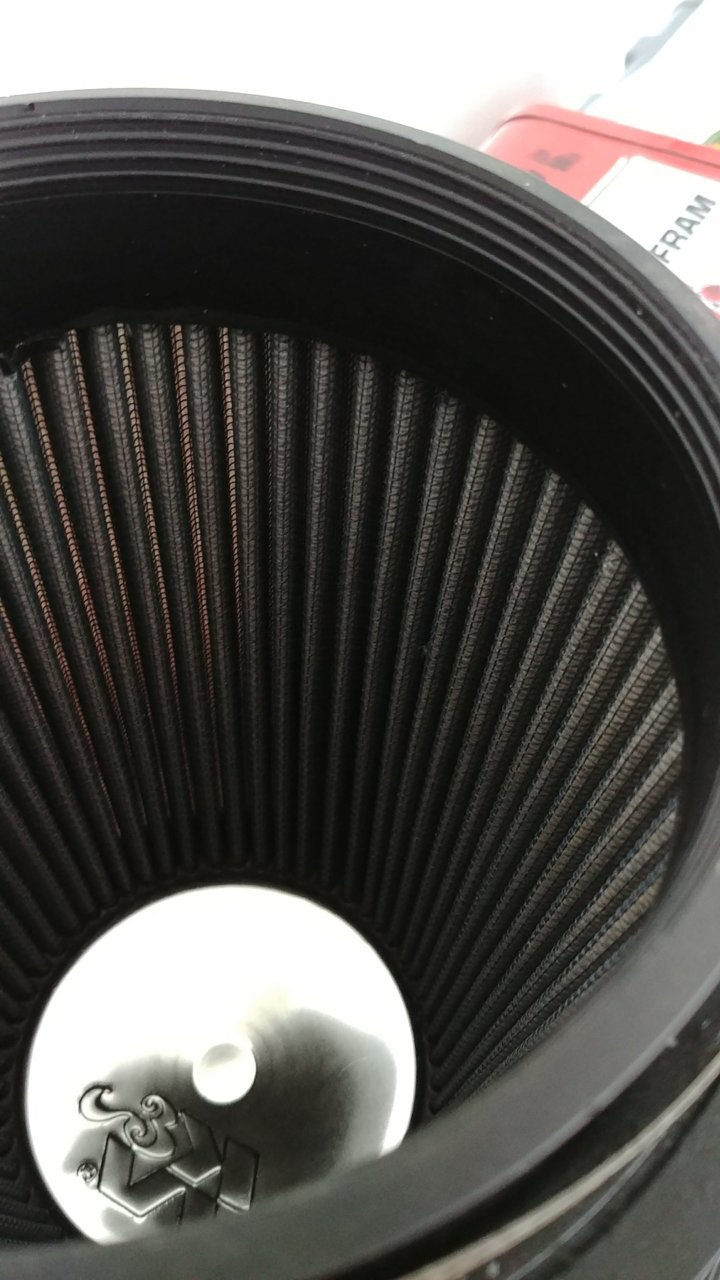

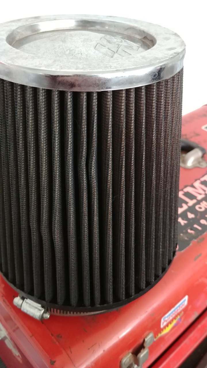

    Simple you add a K&N Dry Charger Pre filter sock over your K&N filter . I've run these on my K&N Filters for years with no issues whatsoever . These Pre Filters work very well in filtering down particulates and and are waterproof
    Now before you go saying these socks lessen airflow , no they don't !! , and yes they're definitely waterproof !!!
    Ive been running a Outerwears https://www.outerwears.com filter sock pre filter on my K&N FIPK and just recently swapped over to a K&N Dry Charger
    these pics below are of my K&N filter that has 5k miles on it . I live up in the High Desert were a lot of sand & dust is constantly in the air . As you can see the filter is very clean inside & outside and the chrome cap on the outside is the only area you see dirt build up
