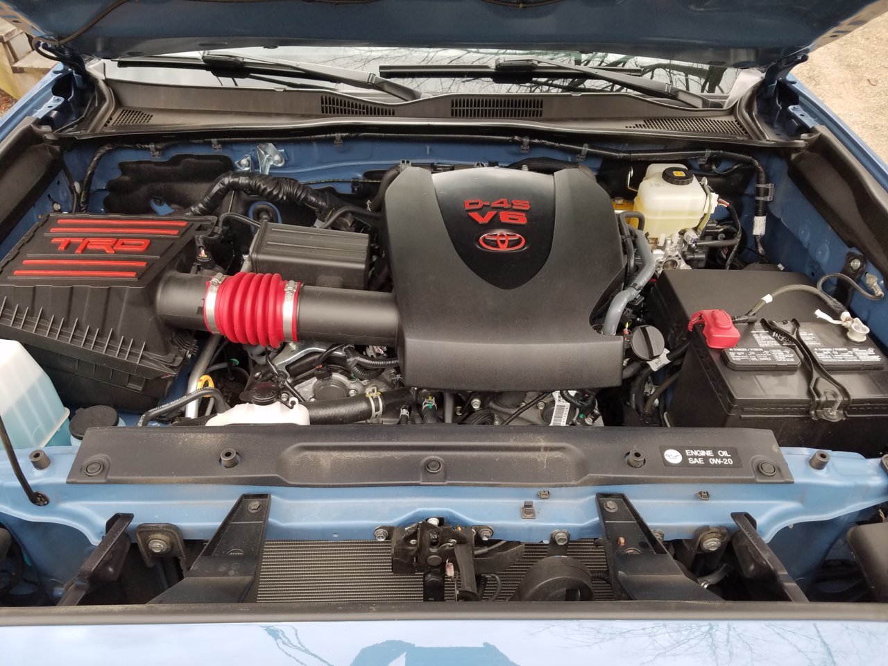

    It's pretty simple. Any CAI that is not boxed only draws warm air from the engine compartment along with much more dust and debris comprising air flow. Simply worse than stock. With that said, yes I have installed a TRD Preformance Intake (that is what Toyota refers to it as). It is a boxed filter intake that is ported out the front fender so as to draw external air. I don't know how much, if any HP is adds but it sure looks sweet. If you are in the market for a CAI just consider boxed over exposed.

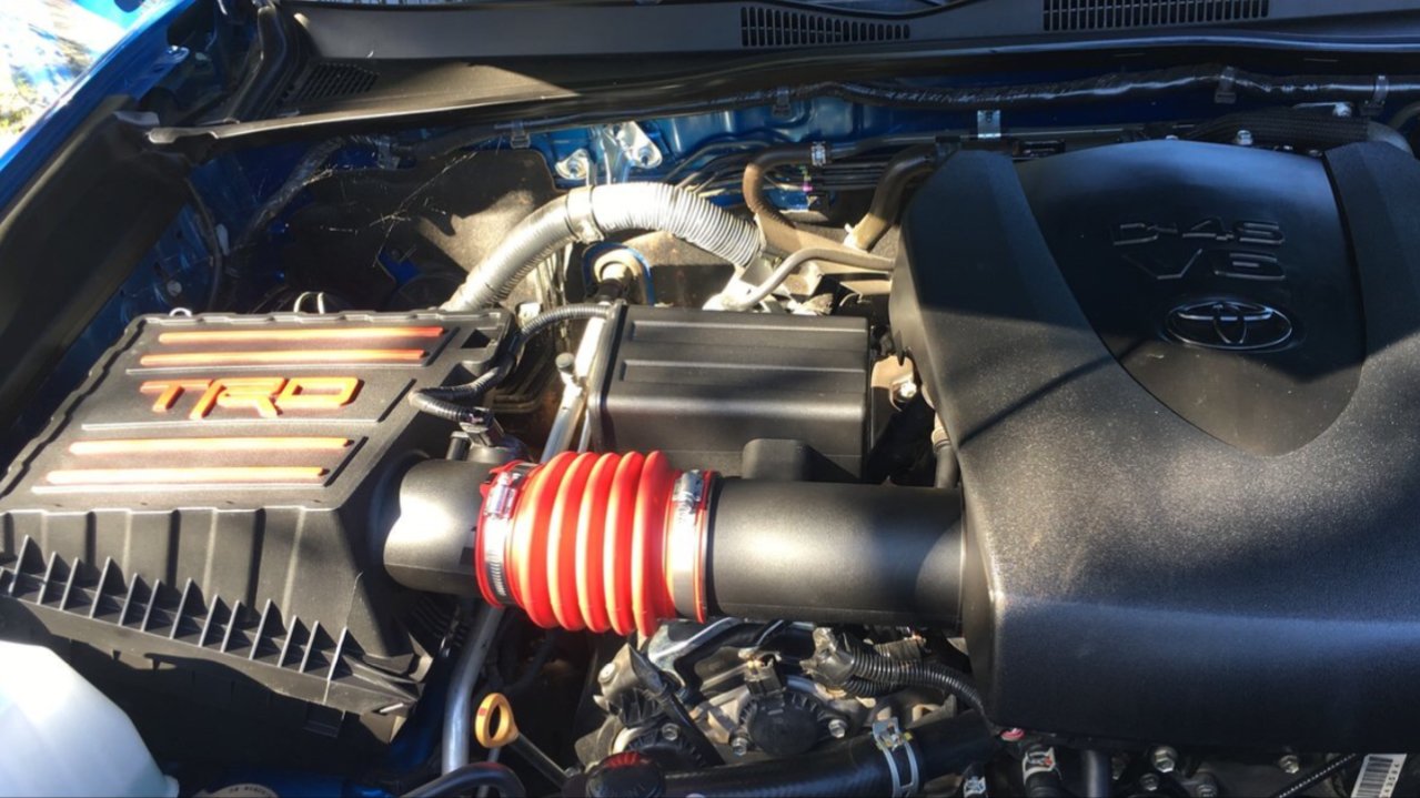

    I installed my TRD Pro intake and filter today. My truck has no other performance mods (except etc always on mod).
    Official butt dyno results... No change. The truck feels exactly as it did before. I can't even tell a noise difference.
    Overall, I'm still happy with my under hood bling and I enjoyed the one on one time with my truck during the install. I've definitely wasted more money on much less fulfilling activities.
    Edit: proof

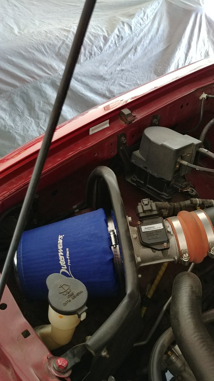

    Old pic of my K&N FIPK CAI , you can see the metal plate that keeps warm engine air from getting to the filter . You can see the OEM rubber gasket that K&N uses to seal the box to the hood and core support /fender area
    I now use a 2' section of 3/4" dia water pipe insulation tubing over that rubber gasket
    This pipe insulation completely seals up this box and only allows cold ambient air into the filter
