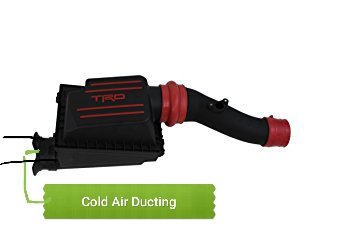

    There are open (or exposed) air filter cai and there are air box cai which are duct usually through the fender so they actually draw cooler air as opposed to hot engine air as in the case of the open or exposed style cai

    I have the same one, never noticed any power difference, but I DID notice a big sound difference.
