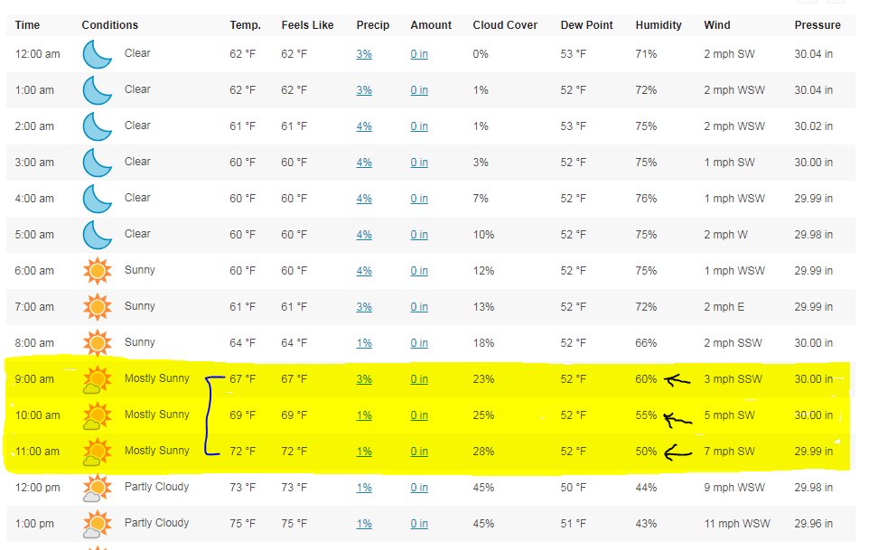

    Should I be concerned about these fluctuations?

    Yes that humidity change only being 5% difference and 5° temp change can drastically change the DA or Corrected Elevation
    You would see 500' to 1k ft change in DA

    What is DA again? How much estimated HP/TQ difference will that difference? Maybe I should run the stock intake first when conditions are better, then run the CAI afterwards to avoid the whole argument of ....
    ( Of course you saw gains because you ran the CAI when colder and less humidity, then ran the stock intake in hotter more humid conditions )

    DA is Density Altitude and is the actual corrected elev for the air at a given moment
    Now that chart you linked with the weather info , here's the DA "density altitude " or corrected elevation
    The highlighted readings with the DA figured in and using Huntington Beach elev which is 39'
    The first highlighted reading
    67° / 52° dew point / 60% humidity / 30.0 in hg barometer the DA "corrected elev " ......649'
    2nd highlighted reading 69°/52° dew point /60% humidity / 30.0 in hg barometer the DA or Corrected elev ......778'
    The 3rd or final highlighted readings 72° /52° dew point /50% humidity / 29.99 in hg barometer the DA or " corrected elev" .....981'
    So reading #1 is elev changed 649 '
    Reading #2 elev changed 739'
    Reading #3 elev changed 942'
