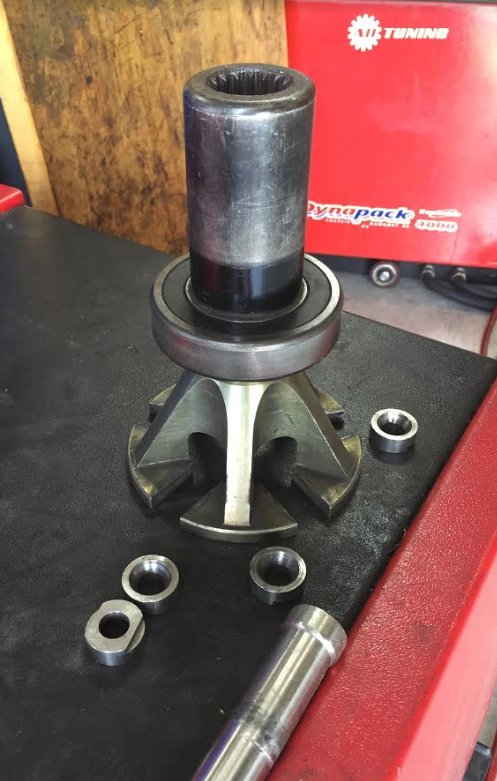

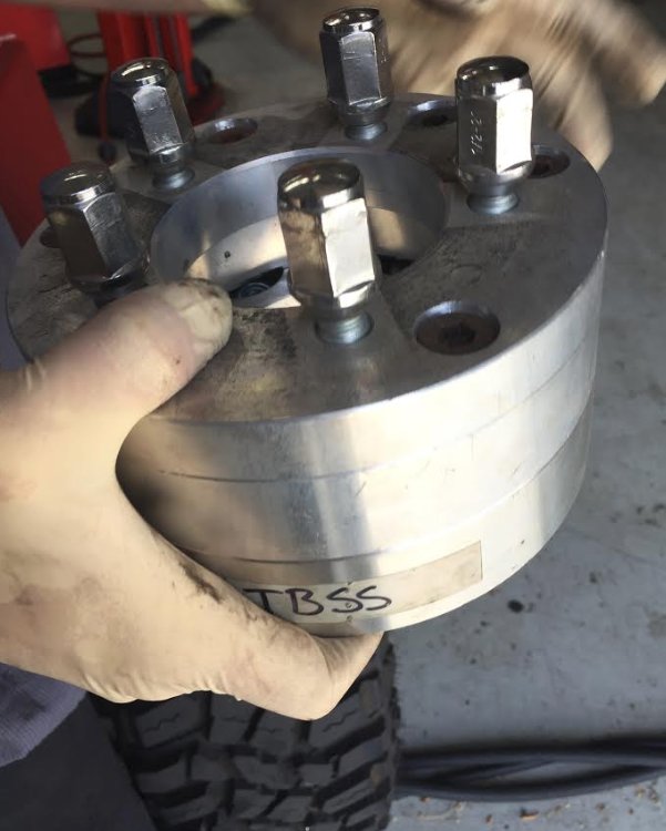

    These were the adapters. My hub was too big. Pretty pissed off right now I wasted all this time.... calling around seeing if any other shops can do it.
