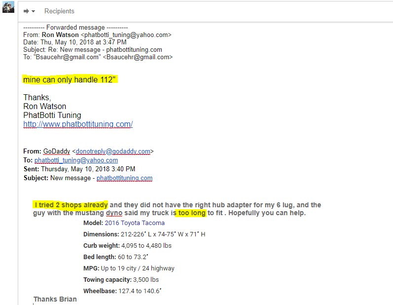

    So I am having a real hard time finding someone that can Dyno my Trail Limo... the search continues

    I tried....they did not have the hub adapter to fit my truck. So I have been trying to find either a chassis dyno or mustang dyno. I would prefer chassis dyno though since its more accurate.

    Mustang dyno is a roller style dyno from what I have been told. A chassis dyno bolts up the the hubs. Have I been misinformed? And I expect a lot of :crapstorm: until I actually get it done, even people claiming I am not looking when Im posting email chains from shops showing the opposite lol

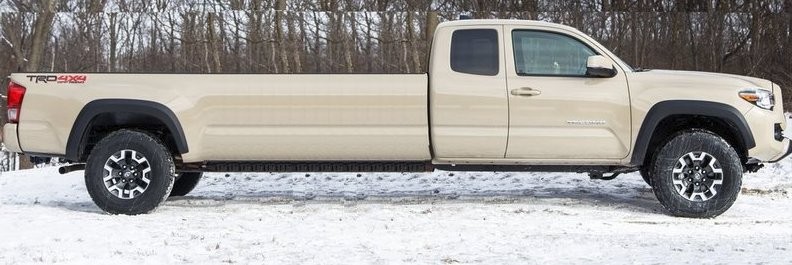

    Yeah, he was highly recommended by most people I talked to, he said my truck was too long just by a little bit. Apparently its not very common for long truck mine mine to book Dyno's around here. I tried hitting up Matt at OvTune but I'm sure hes way to busy for my myth busters experiment haha

    You have been misinformed. Two main types of chassis dyno - inertia and eddy current. Mustang is an eddy. The type that bolts in place of your wheels is an eddy. DynoJet is typically an inertia, but some have an additional eddy current module attached.
