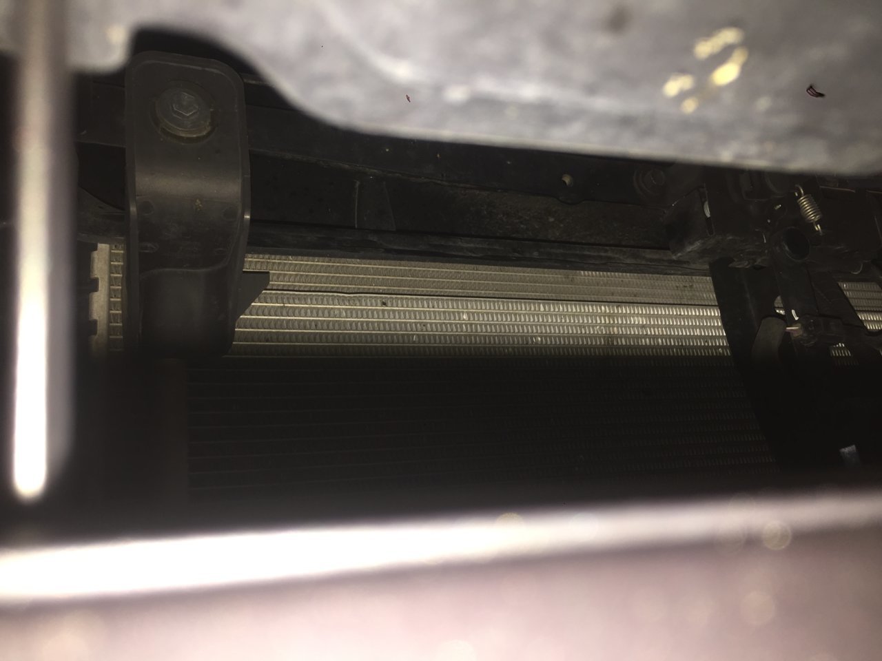

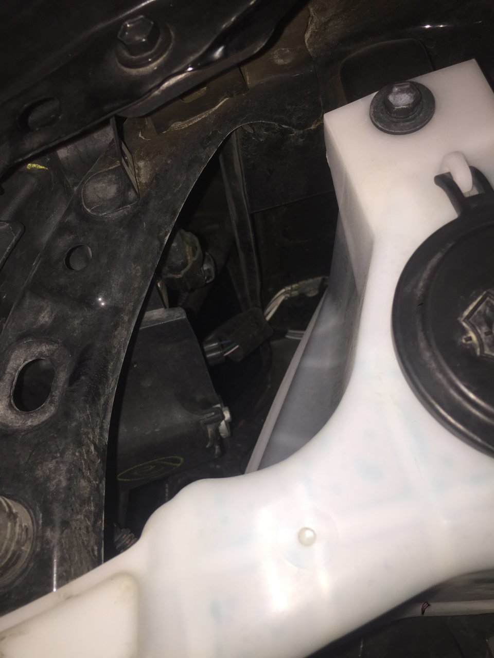

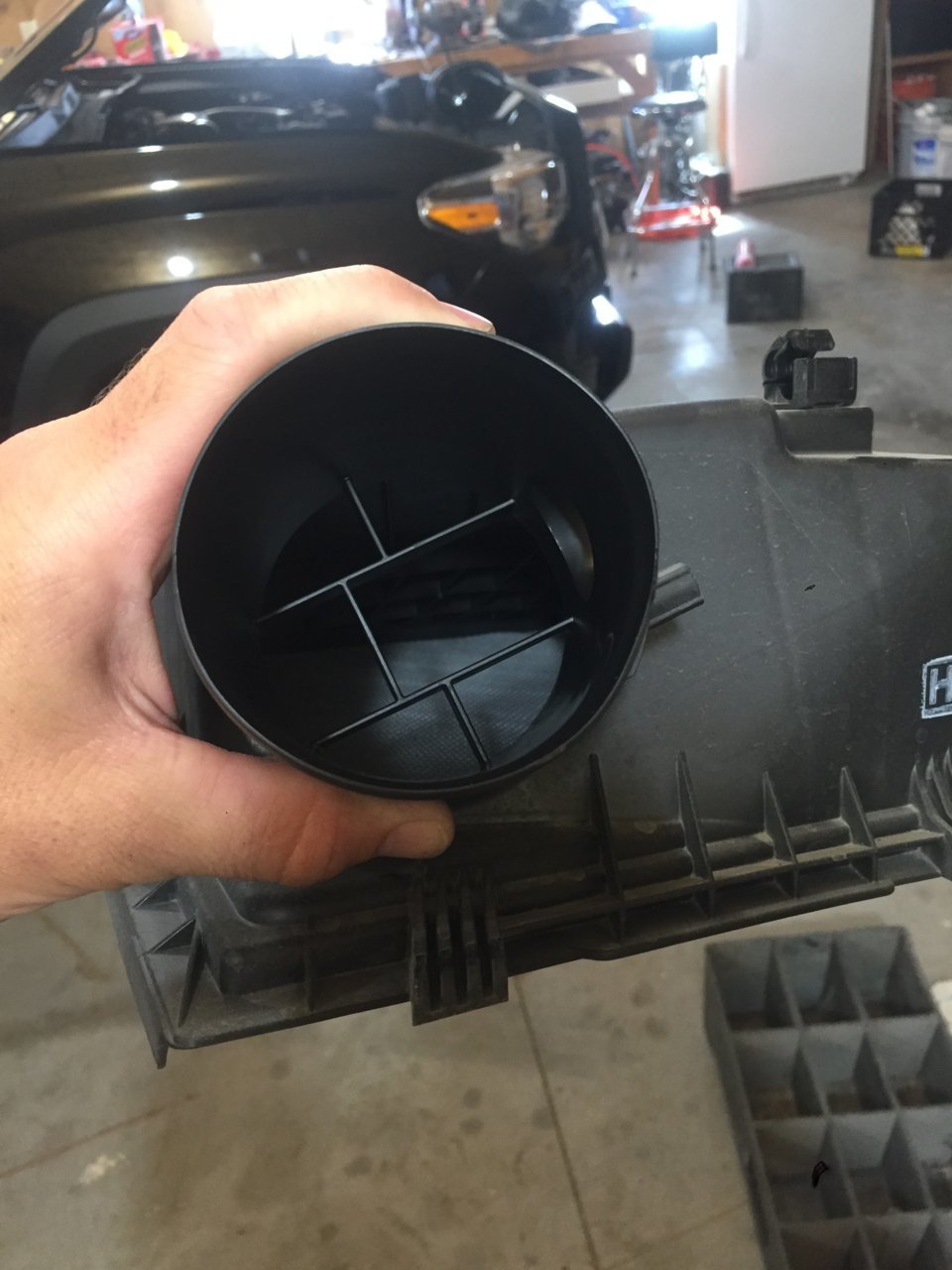

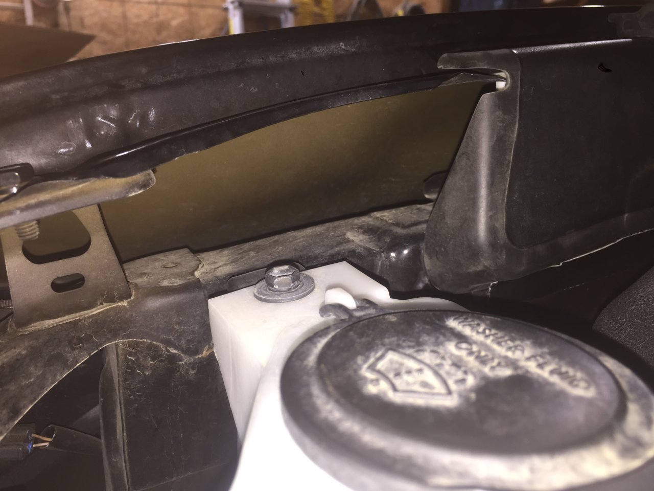

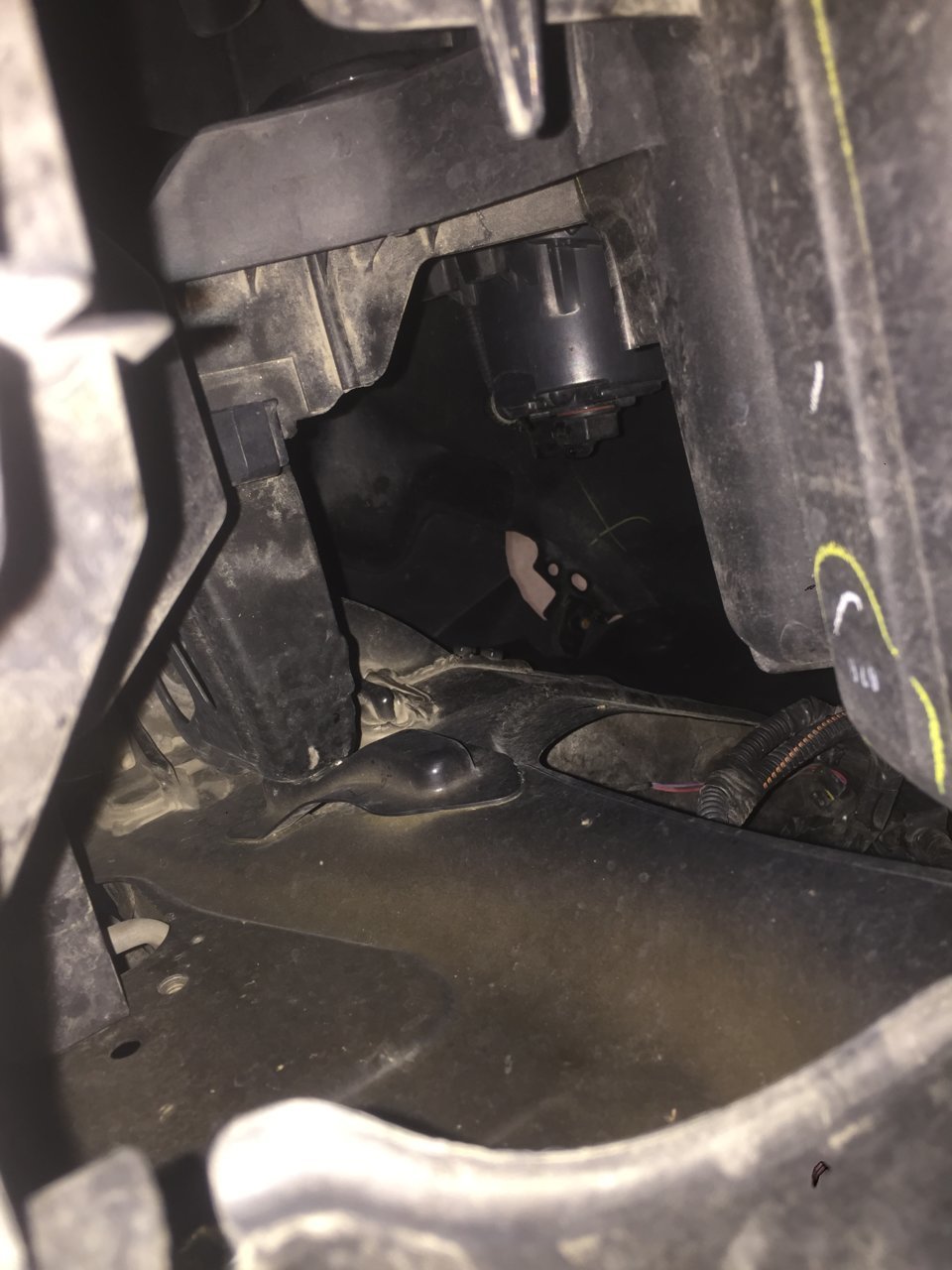

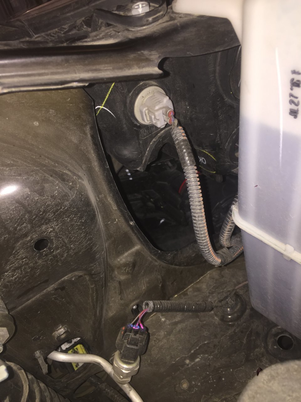

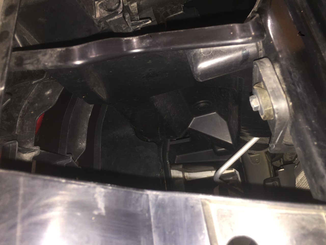

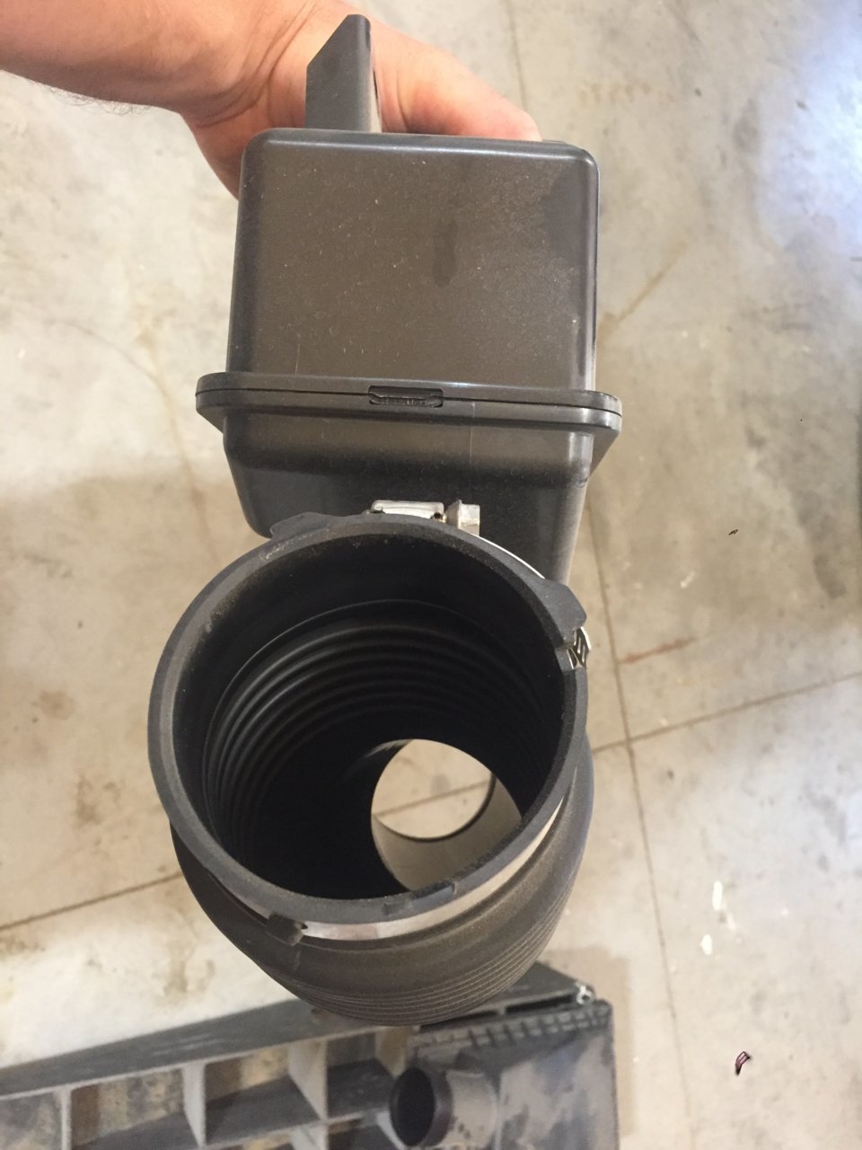

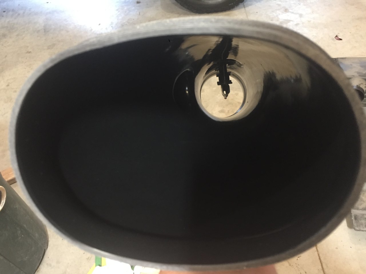

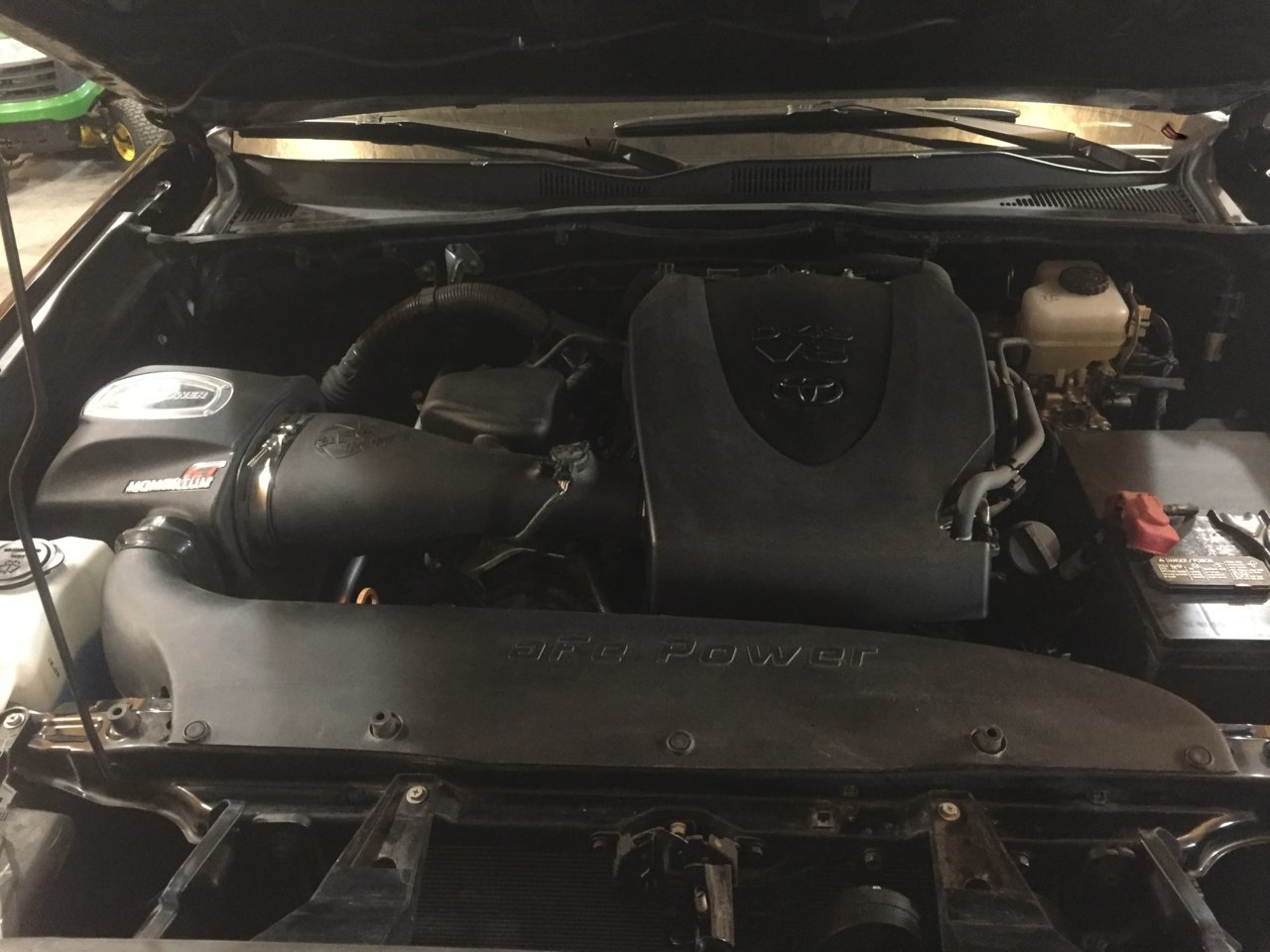

    I installed my AFE intake on my 2017 that I had removed from my 2016. I took some pictures to share.
    So much talk about what is the necessary air requirement for this engine in regards to the capability of the filters themselves. What about other factors like bends in ducting, change in flow direction, and where the air is coming from?
    AFE vs OEM
    For most efficient flow, post filter,
    This?:
    Or this?:
    ...Plus this:
    Only cold air enters the inner fender, right?
    The air behind the grille is directed towards the radiator and away from entering the inner fender.
    Where does AFE pull air from? All the same places:
    Except, air can also come from above the radiator with the optional scoop (where the ambient air IS directed after entering the grille):
    Now I haven’t actually seen what the IAT’s are before and after this installation, so all of this may mean absolutely nothing. These are just observations that I have made from first hand experience and it seemed like this was a good place to share.
    On my 2016 MT, I thought that there was some mild gains in the lower RPM’s, a somewhat flat feeling around 3500 RPM, and noticeable gains in the higher RPM’s. Placebo? IDK. I thought that I’d give this system another chance on my 2017 AT. As of this moment, I haven’t left the garage so I can’t comment on how it feels on the new truck.
    I’m anxious to see the before and after dyno charts when the OP can get it done!
