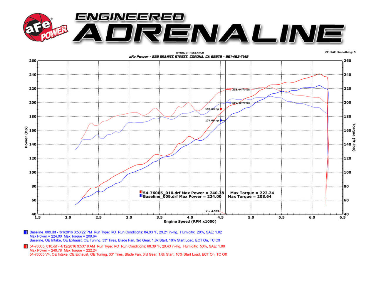

    This is the chart that AFE provides to sell the Momentum GT. On their dynos, we know that they ambient air was about 16* cooler with their intake compared with their stock measured dyno run day, but the humidity on the colder day was slightly higher. We don't know the correction. We also don't know if they maybe used premium fuel or did an oil change, or anything else which could be in the margin of error. Maybe the stock filter was dirty and they compounded all these factors to make it more appealing. At least they did state the ambient temp. It also doesn't state whether it was with the front ram air scoop, which I suspect it must have been. This intake seems almost identical to the iNTECH in design. If insurance pays for your intake, get a stock one to always have. If you MUST get an intake, I would go for the iNTECH or the AFE, but I am not sure if there is any way to ensure no CELs for every single vehicle.
    Edit: This was also in 3rd gear and not a 1:1 gear for a 3rd gen. I am inclined to believe that there is a very marginal gain for $500 and I am not aware of the filtration efficiency of the filter other than their claims of 97% if I remember. The tests were also over a month apart. A little too much "Engineered Adrenaline" for my liking.
    What do you all think?
