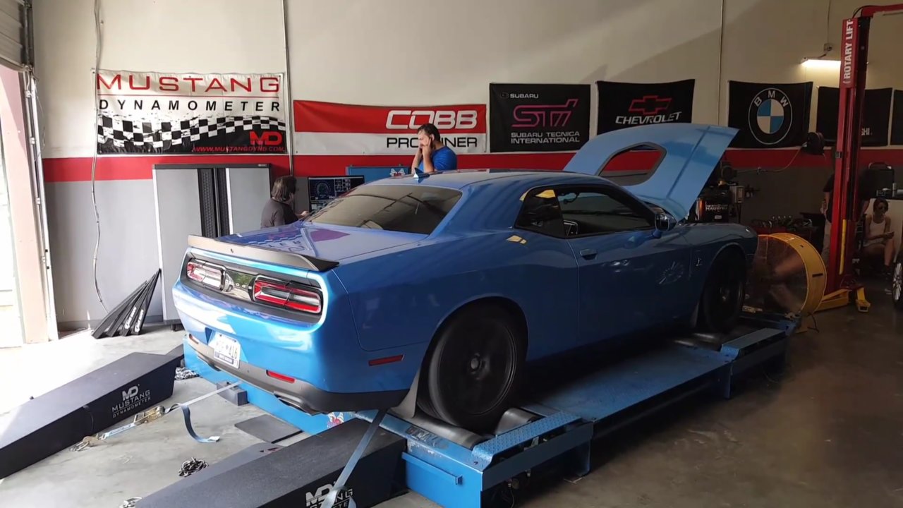

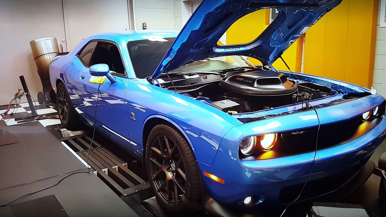

    My bad. Thought I saw where you were replicating K&N's dyno, and I thought that was only 1 pull apiece.
    If you plan on doing other mods other than the K&N, be sure to always dyno on the same machine at the same place, with preferably the same operator.
    2 identical dynos can measure miles apart.
    There's usually a 10-12% loss in power in a manual drive line. And a 12-15% loss in an automatics driveline.

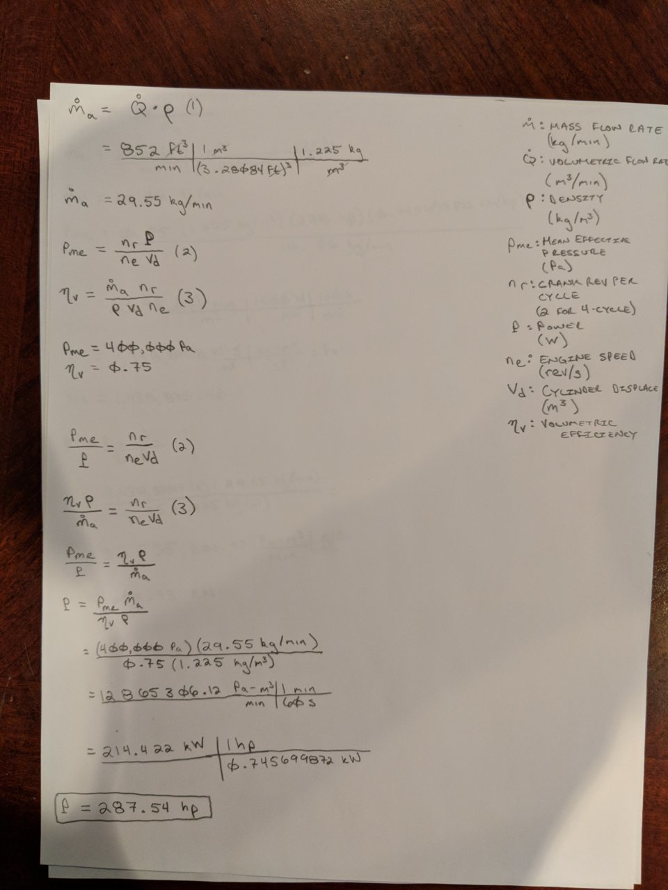

    Based on some basic engineering equations the theoretical power that increasing the air flow to 852 cfm yields 288hp. That's 10 horse increase. That's assuming that the engine adds more fuel to the extra air to make it effective.
