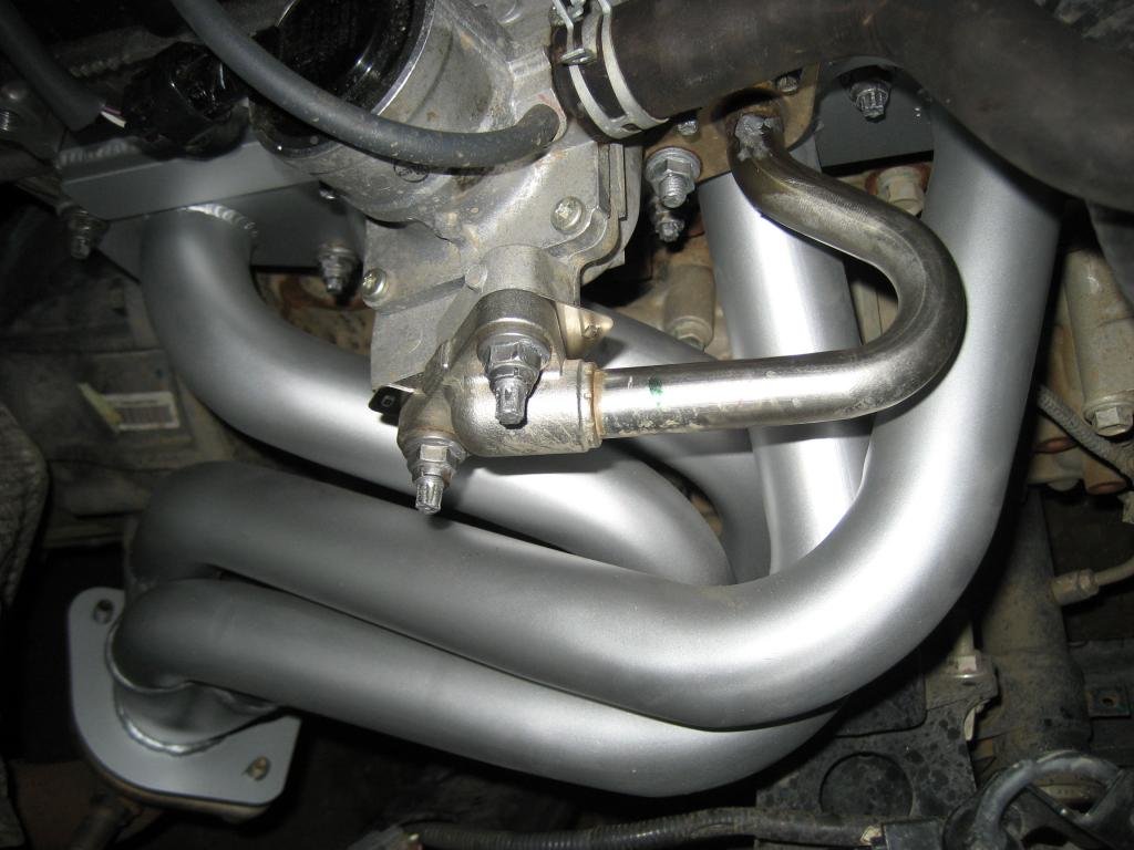

    From my own experience I'd say that headers are the best bang for the buck mod as long as you don't open up the rest of the exhaust system and lose your low end torque.
    While I don't know about 4-2-1 Doug Thorley headers because there doesn't seem to be any 2.7 specific dyno charts on them, I did run a dyno test with an LCE 4-1 folded long tube header on my engine...
    ...and it lowered the torque peak by 650 rpm from 3,800 rpm down to 3,150 rpm. The run with the header is the blue lines.
    The red lines are the dyno run with the combination of the header and an intake manifold spacer.

    The best bone stock 2.7 dyno run I've seen so far is: 119hp 133tq
    I did dyno runs on my 2.7 with only these mods:
    Injen long tube intake
    LCE long tube header...
    No power steering or air conditioning.
    ...and it made: 135hp 158tq
    So the combination of those mods netted gains of 16hp and 25tq.
    Intake: $220
    Header: $473
    ...for a total of $693.
    Greg

    And the intake manifold spacer added a couple more of each to make 137hp and 160tq.
    So from 119 hp to 137 hp is 18 hp is 15% increase in horsepower...
    ...and from 133 tq to 160tq is a 20% increase in torque and that higher peak torque is reached 1,100 rpm sooner, at only 2,900 rpm instead of the 3,800 rpm peak on a bone stock engine...
    ...and this is with just the stock ECU, no tuning, and cheap regular 87 octane pump gas, so I'm really pleased with how this particular combination of mods has worked out. :)
