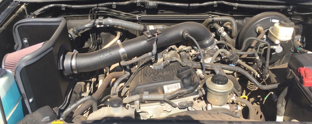

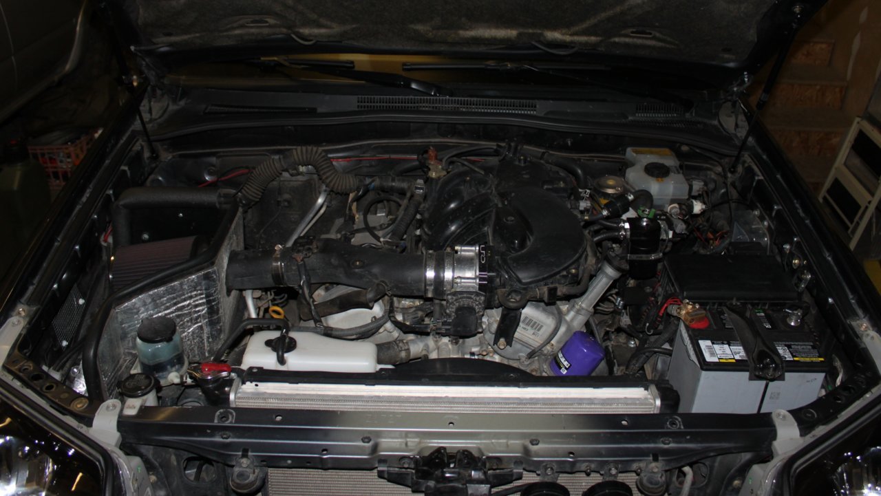

    Would be interesting to see if anyone has bothered to disconnect the battery after installing a "CAI", so the computer has a chance to adjust to more air.
    Due to the nature of a fuel burning engine, if you add more air you will burn more gas...not better MPG.
    My observations...take with grain of salt. K&N 63 on a V-6 2004 T4R.
    Just adds noise.
    After you are moving 10+MPH you are getting the same temperature coming into the front grill area as you do from the fender/wheel well. (Scangauge2)
    So to me a true CAI is good for rock crawling or drag racing.
    Intake air temp is hotter, but only 10*, and that's at below 10MPH.
    Sitting in traffic last summer I had 130* at intake, 96* outside temp, not moving.
    I like that I can see if my air filter is dirty at a glance.
    I can clean it.
    Never had a MAF sensor issue. (over oiled)
    Rodents have to chew metal mesh to get into the motor.
    It is louder. I like, sounds different than the soccer moms T4Rs.
    I get more dirt/mud/snow into the open fender hole to air intake than when it is sealed off.
    Adding exhaust and the URD MAF CAL seemed to help out the overall 'feel' of the intake mod.
    Seems like you have to modify the computer to get any real butt-dyno improvement.
    The last best bang for a buck CAI looks like that S&B to me.
    https://www.sbfilters.com/cold-air-...ed&utm_term=s&b intake&utm_content=S&B Intake

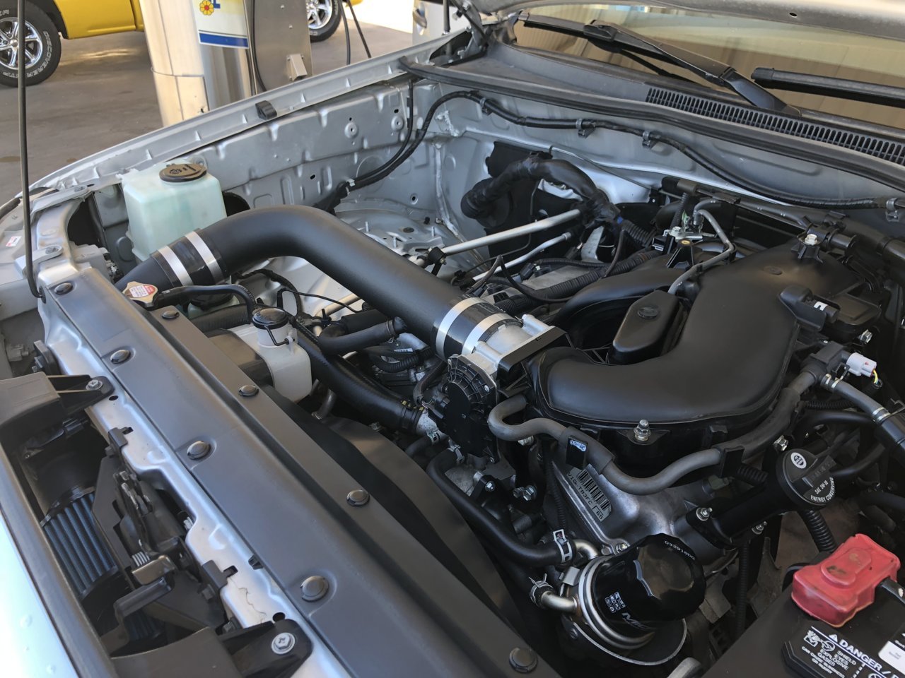

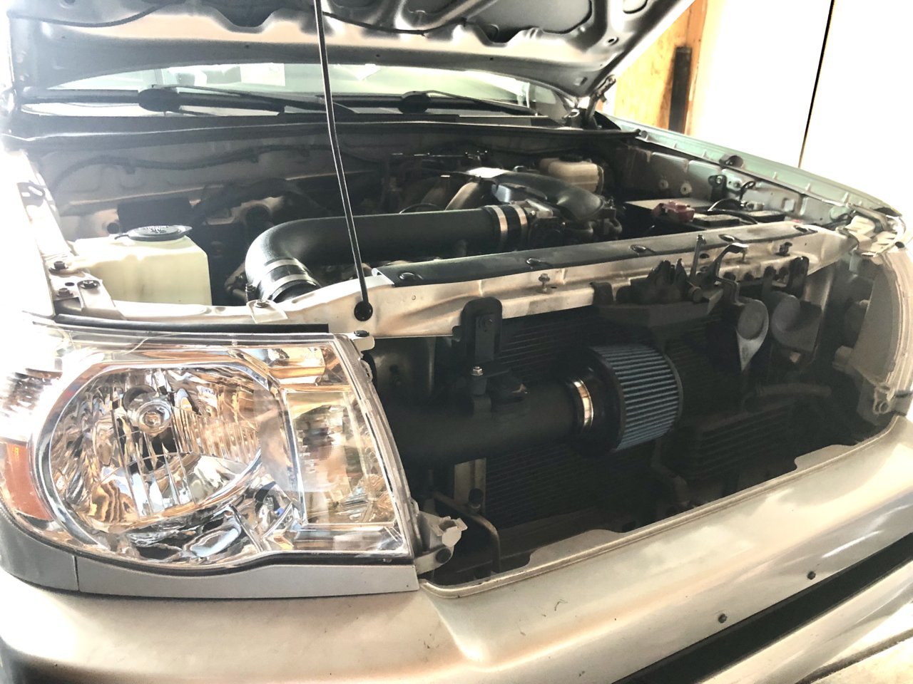

    If you decide to go with K&N, make sure you do not run an “oiled” filter. Your MAF sensor will hate it and you will constantly be clearing a P101 code.
    I did tons of research on intakes before I bought mine, and ended up with the URD True cold air intake. It’s cheaper than the K&N, sounds better (IMO) and looks better. Plus I don’t get codes and there is a noticeable difference in power and MPG for me.
    Unpopular opinion: hindsight being 20/20, I’d save my money. There is no such thing as a fast Tacoma, I don’t know why aftermarket performance modifications even exist for our trucks. But, it does sound cool and gets people’s attention :cool:

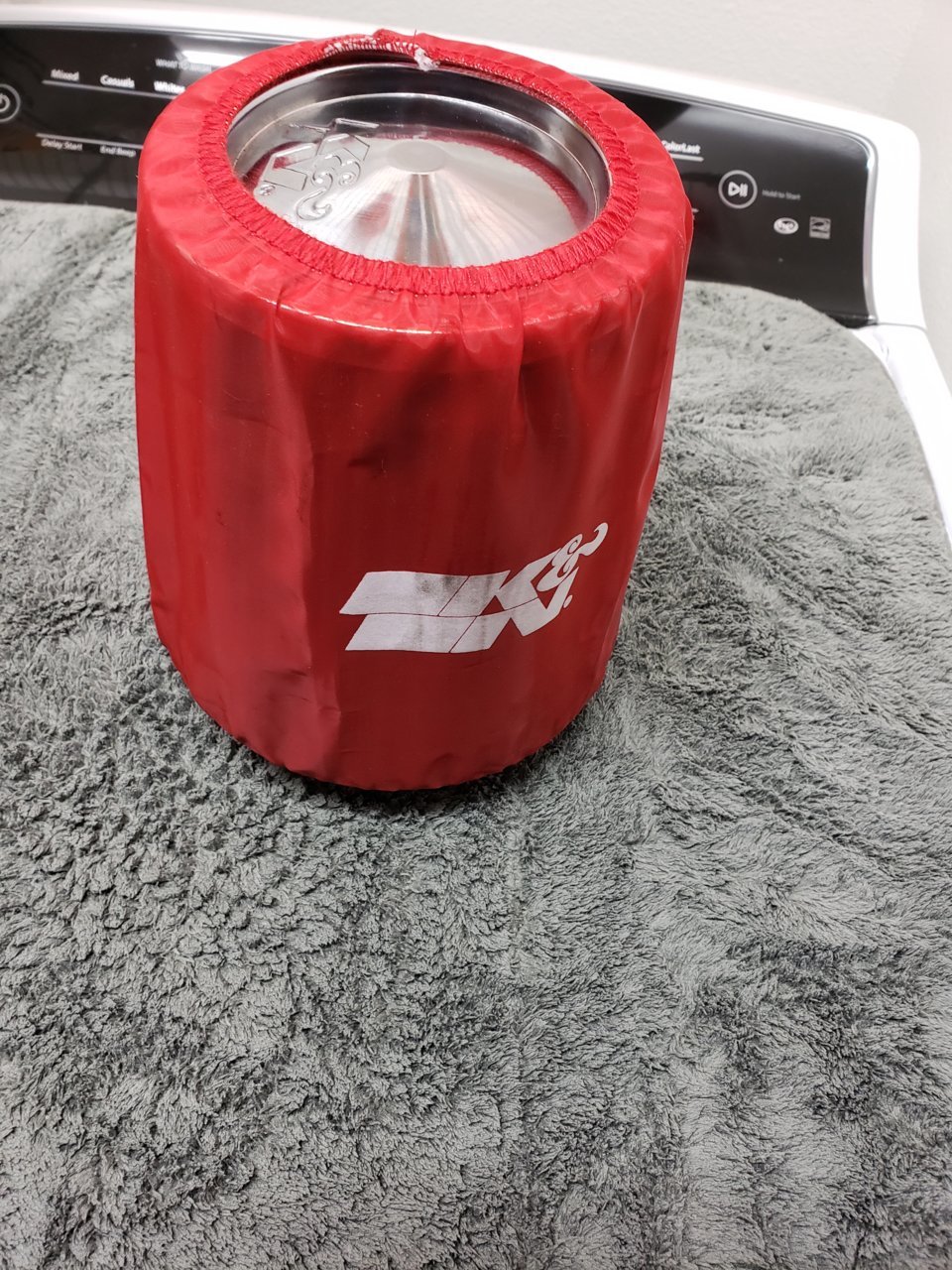

    I'm running a K&N CAI on my 02 DC Pre Runner with a supercharged 4cyl I never have any issues mentioned in the hundreds of posts on here .I also have (2) K&N Filters one with a Outerwears pre filter and the other has a K&N filter sock . One is always ready to install pre oiled and pre filter on
    I swap out the filters at every oil change and the filters are clean
    Filter ready to install
