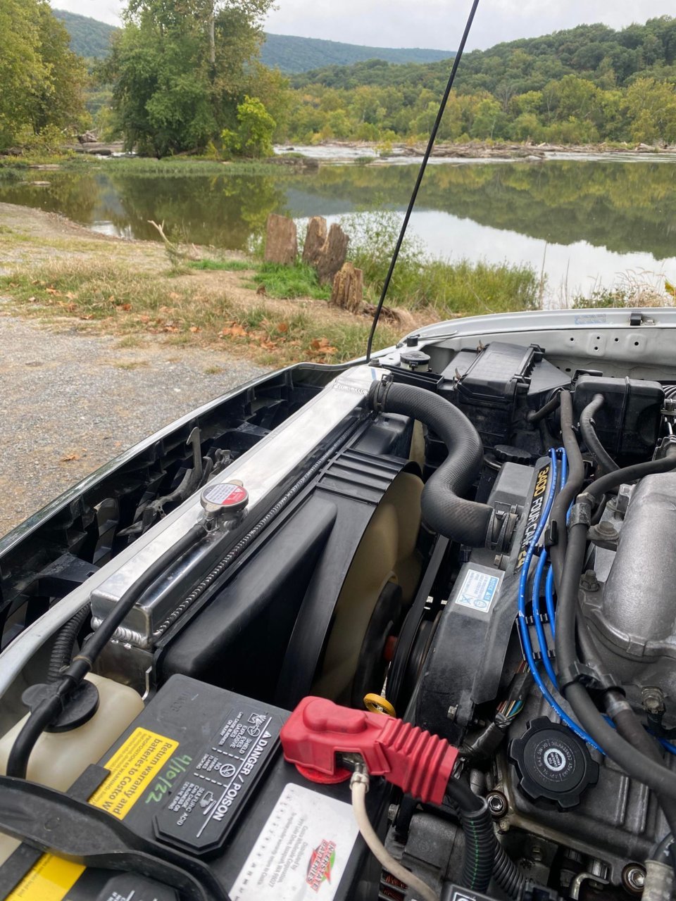

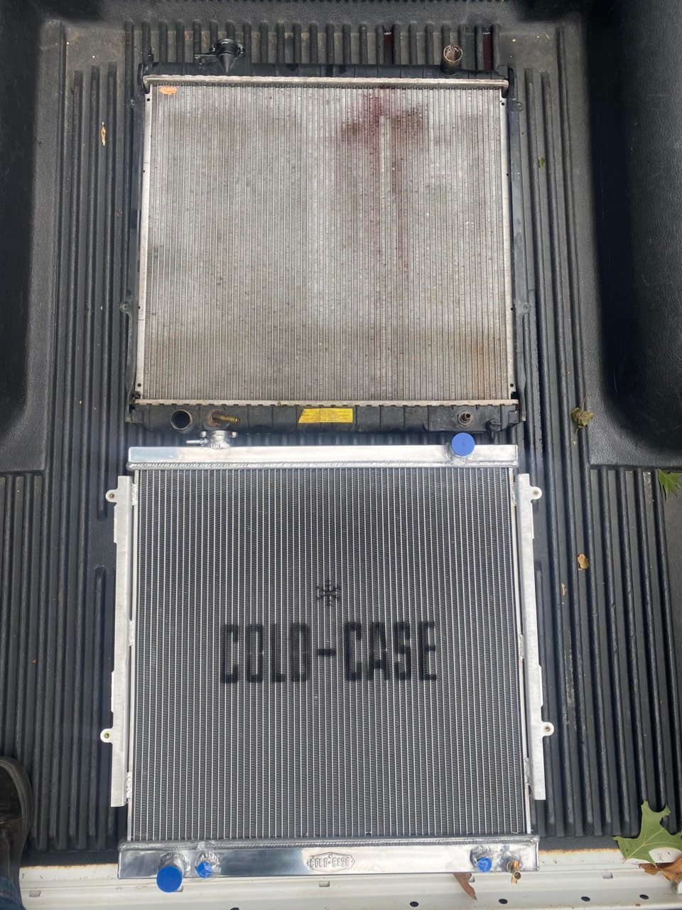

    Got the radiator in and installed. Seems pretty nice, glad I went this route because I didn't end up having time to get the trans cooler installed because I was trying to get this buttoned up before it started raining.
    As far as fit, it was pretty close to factory, the only issue I had was one of the rivnuts for the radiator was about a 1/8" off and I couldn't get one of the mounting bolts in. Ended up knocking the rivnut out and just using a nut and bolt. Everything else was fine. I did a pressure test after getting everything installed and it held pressure for 10 mins before I moved on with things. During my test drive I was dogging the truck pretty good on mountain road and the temps didn't get over 200 degrees. I should mention I have no idea what temp thermostat is installed, haven't gotten around to replacing that myself.
