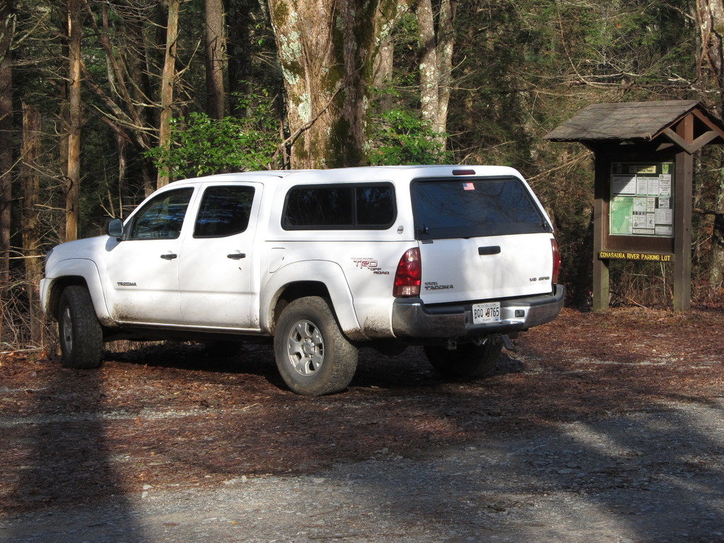

    A 265/70/17 is 1" taller, same width, than a 265/70/16. I've been running 265/75/16's on my Tacoma for 3 years. They are the same diameter as the 265/70/17's, but slightly narrower.
    It will effectively change the axle ratio resulting in somewhat less power. It will change the odometer and speedometer slightly. In my case the speedo is now accurate. It used to read 3mph faster than I was actually driving. If you are within 3-5 mph of the speed limit you won't have a problem. With a couple of exceptions it is illegal for most cops to write a ticket here in Georgia unless you are 11 over the posted limit anyway. A school or construction zone are the exceptions.
    But a little perspective. The difference in power is minimal. If towing near the max it might be noticeable. Going up 2-3" makes a noticeable, and unacceptable difference in my opinion. Unless you go to the trouble to re gear. Since I stayed with the same type tire, just 1 size larger there is zero difference in fuel mileage with my truck One inch just isn't enough to matter much. In fact, a brand new 265/70/16 will be EXACTLY the same diameter as a 265/70/17 tire at some point in it's life as it wears down. In fact the 17" tire could end up being shorter near the end of it's useful life than the 16" tire when new.
    I'm convinced the WEIGHT difference going to an LT tire vs a P series DOES NOT impact fuel mileage or performance. Most people who go to an LT tire also go to a tire with a much more aggressive tread that increases rolling resistance. It is the tread pattern that reduces fuel mileage, not the weight. A hwy tire will give best fuel mileage in either a P or LT tire. The more aggressive the tread, the more power it takes to turn them and they don't coast as easily when not getting power. I've seen 2-3 mpg loss going from an LT hwy tread to an LT mud tire. The really aggressive treads aren't offered in P series tires.
    I like the look, and found a 265/75/16 tire to be cheaper than 265/70/16, and because it is a more common size found far more options. I'd make the change and not worry about it.
    My truck with the bigger tires. I waited until mine was 6 years old and over 120,000 miles. I wish I'd done it when I bought the 1st set of tires.

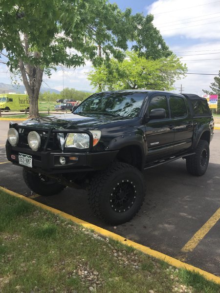

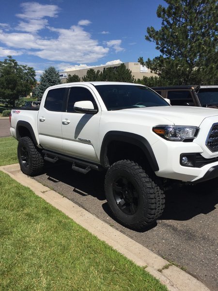

    image.jpg image.jpg I had an 06 with 35s that I drove for over 100k miles without any problems and I expect that from my 16 taco as well. Life to short drive what you like!

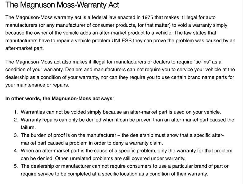

    At least there is some ground to stand on and thats why I had my lift installed from a certified installer and I'm covered for 5 years or 60k miles. They at least stand behind their products.
